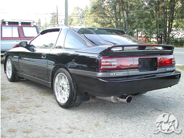

OK, here's what I am going to do/have done with my engine;
1. Upped exhaust to 3inch. It's excessive, but I plan on getting a 1JZ soon. 2.5" is plenty enough. By the way, when people say they've added a bigger exhaust it usually means they've also matched their downpipe and turbo elbow with the same size. Just doing the exhaust piping is not enough.

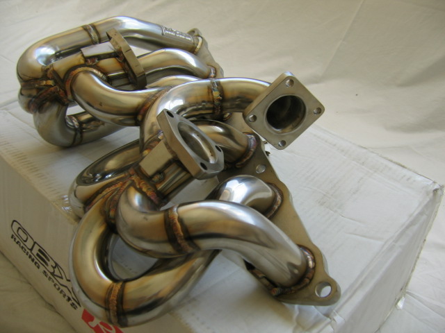

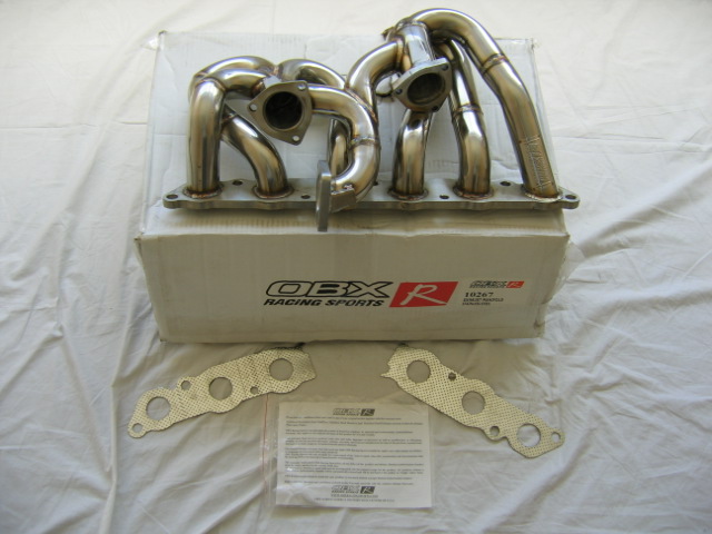

6. Exhaust headers. You NEED this before getting a boost controller. I'm buying this one from OBX since they are the only manufacturer I can find that does one for the 1G-GTE twin turbo design. If you're going to switch to a single turbo, then good luck in finding a header.

Your car looks nice bro... engine looks so clean....
those OBX are they american brand, am i available to get these in australia.
ive got a 2.5 piping but no extractors or piping from turbo but i can feel that its not pushing enough out allready.... when go above 4500 rpm.
How much for those extractors roughly...

Not sure what brand the OBX are, but I found a couple of them on eBay. They were going for $370 Canadian at the time, which is pretty damn cheap if you ask me. You should be able to grab 'em off there.
