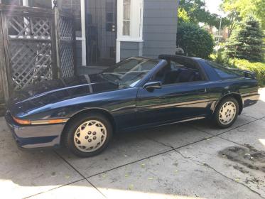

Hello
New to this forum. I bought my daughter a 1988 supra turbo auto car that is now throwing a 52 code. It runs and idles fine. When it's going down the road less than 20 mph or shifting down into a lower gear is when it seems to run like it's missing. After a long trip if you try to restart if it's been sitting for like 30 mins it will start hard like it's rich. Any help will be great. I'm an old school muscle car guy so I know nothing on these cars.
Thanks
