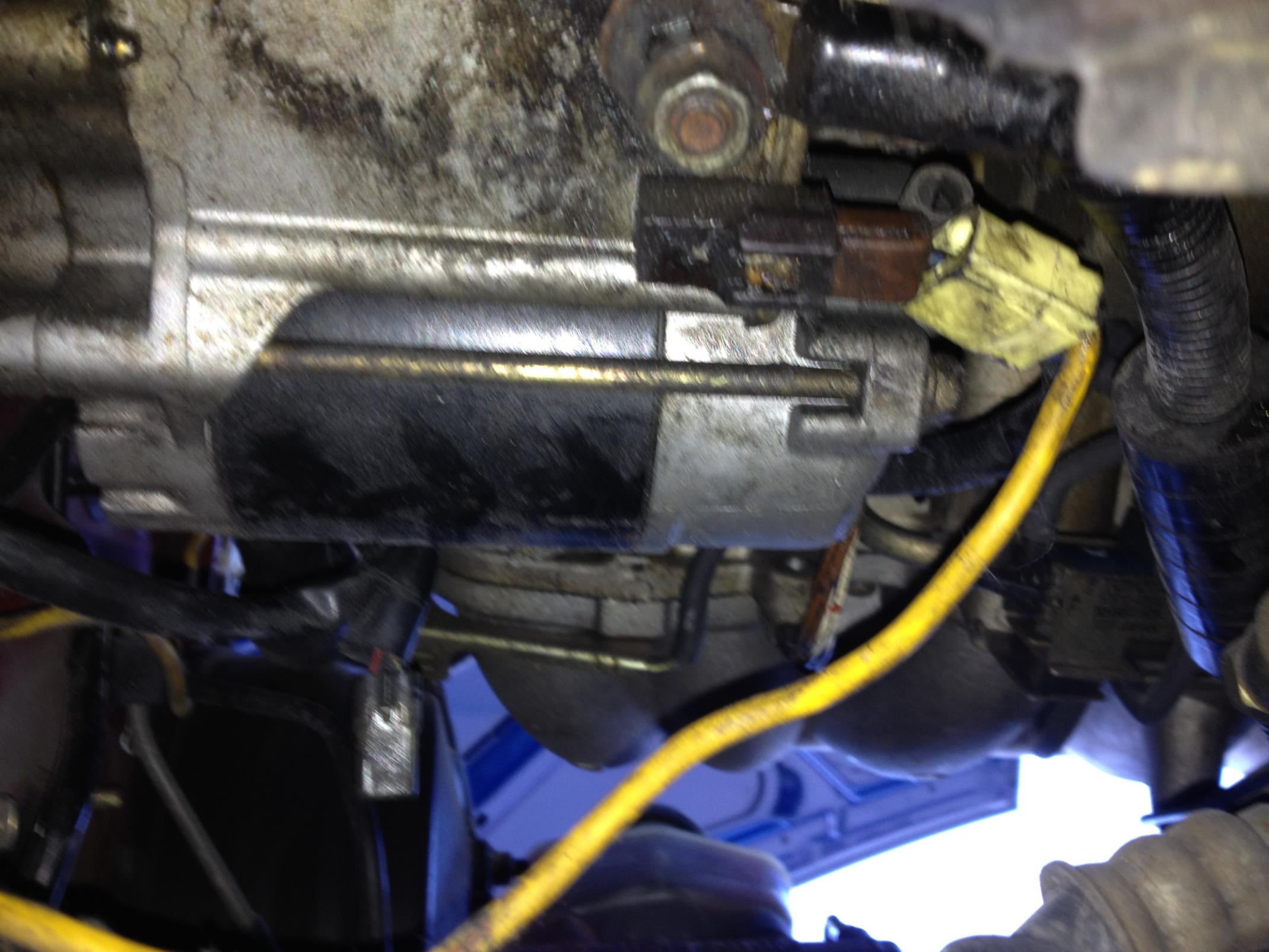

Found that I'm not getting power at the fuse link in the relay/fuse box under the hood. I am getting power at the starter but I had some questions about that. I for sure am getting power to the starter, but I cant find the power out of it.(although part of that could be that I am having a hard time getting to the starter since I dont have a jack yet.) I also am concerned about the wires that I see coming out of it. Any feed back would be good.

The main positive cable that goes to the starter is directly connected to the battery; you should always have power there. The little wire is what triggers the starter to run, that wire should only have power when the key is in the start position

Yeah, one of my concerns is that the yellow wire there goes into the firewall up high and there is also a bundle of wires(looks like the original harness) that goes forward and splits up by the battery.

Looks to me like they just used an insulation piercing tap to replace the old, high gauge solenoid wire. It's probably run right up to the starter relay inside the car. Not a big deal although I would just ditch the splice and put a regular spade connector on the yellow wire and toss the little piece that's left from the factory wire.
