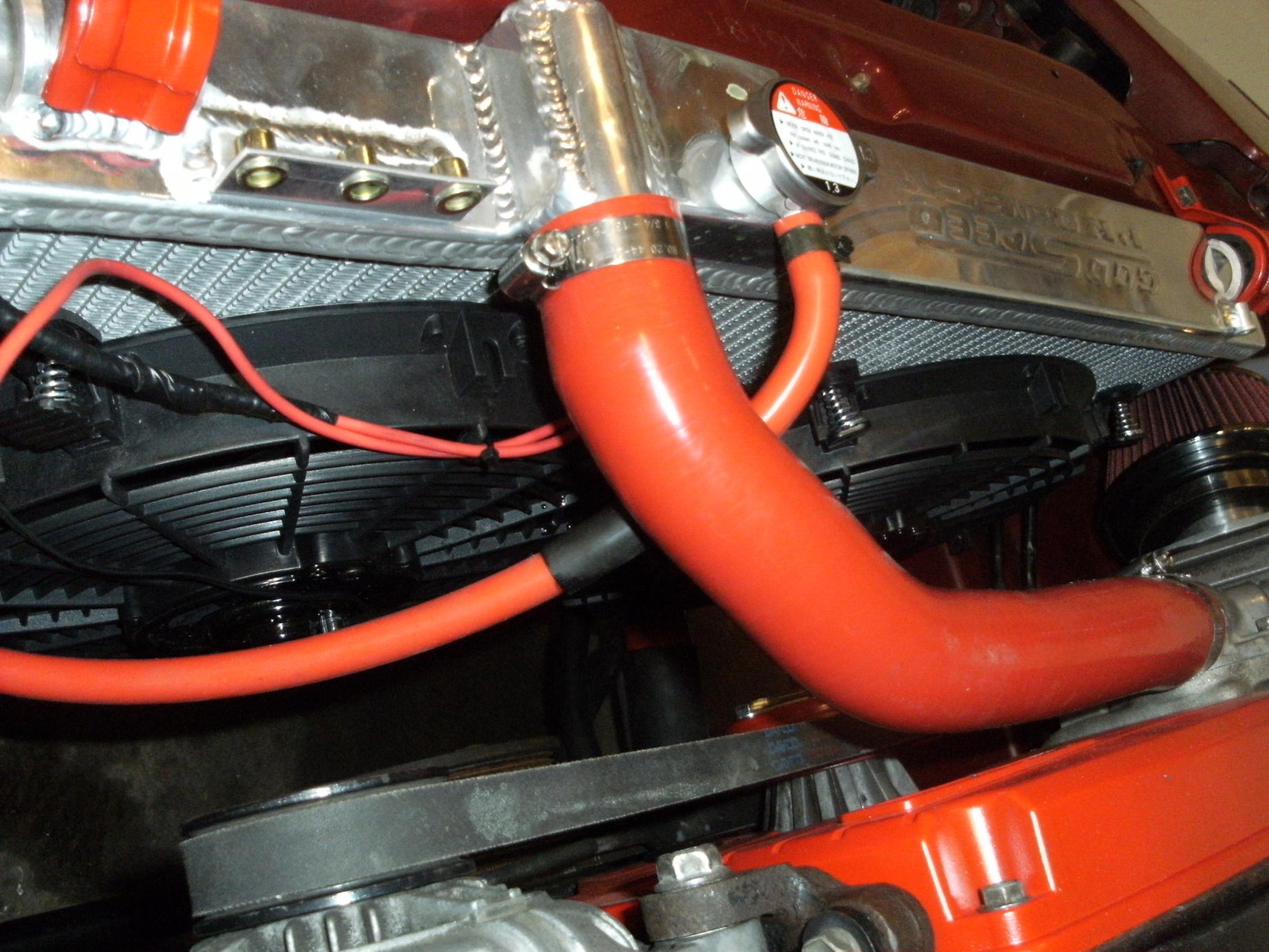

I recently bought a radiator off of EBay. This one here.
http://www.ebay.com/itm/120787707077...ht_5564wt_1169
Now I'm just wondering about wiring the fans in. I've read that i would need to wire them to a thermostat and the battery. But is it possible to just wire them to the wires that ran to the stock electric fan? And I'm assuming that removing the mechanical fan is ok and i just have to get some nuts and bolts that will keep the pulley on. Help is appreciated guys.

No. And the A/C temp switch which some recommend comes on at a higher temp than is generally desired... You'll need a thermostatic switch for the right operating temp and a dedicated wiring harness (don't forget the fuses and relays!).
Yes. If the hit the spot on the studs where there are no more threads you may swap out the studs for some bolts about 1/2" long... I'd use hardened bolts for a little more piece of mind.
Do note that that is for a JZA70 chassis/engine setup and not a MA70. It's not a big deal but schedule some extra time in there for correcting any fitment issues and go buy a plug for the opening by the drain before you start. As they ditched the fan cowl and the A/C fans you obviously don't have to worry about fitting those but the rubber feet will need to be shortened a bit over 1/8".... I can't recall if there's anything else.

The aux fans don't come on when you want for primary cooling. 225?F+ = way too hot. You want it to come on around or before 190?. None of the other temp switches operate at the correct temp either so repurposing is out there as well. I also wouldn't trust the thin, stock wiring for prolonged use with much larger fans.
I don't recommend electric fan conversions for most cars which come with mechanical fans. An aluminum flex fan is just as efficient (or more if you listen to the sales rep), if the clutch fails you're not dead in the water and for some reason people do an amazing job of fucking up wiring when installing an electric unit... Generally it's ignorance, short cuts and cheap hardware which gets them.

OK. So i did some research and decided to buy this here.
http://www.summitracing.com/parts/DE...n/?prefilter=0
It includes a probe, relay, and thermostatic switch. Now another question arises. If i have it wired directly the my battery the fan is going to stay on until the temp. drops. What wire can i tap into so that they will only run when my key is turned? With just the electronics running is what im saying. Any ideas?
