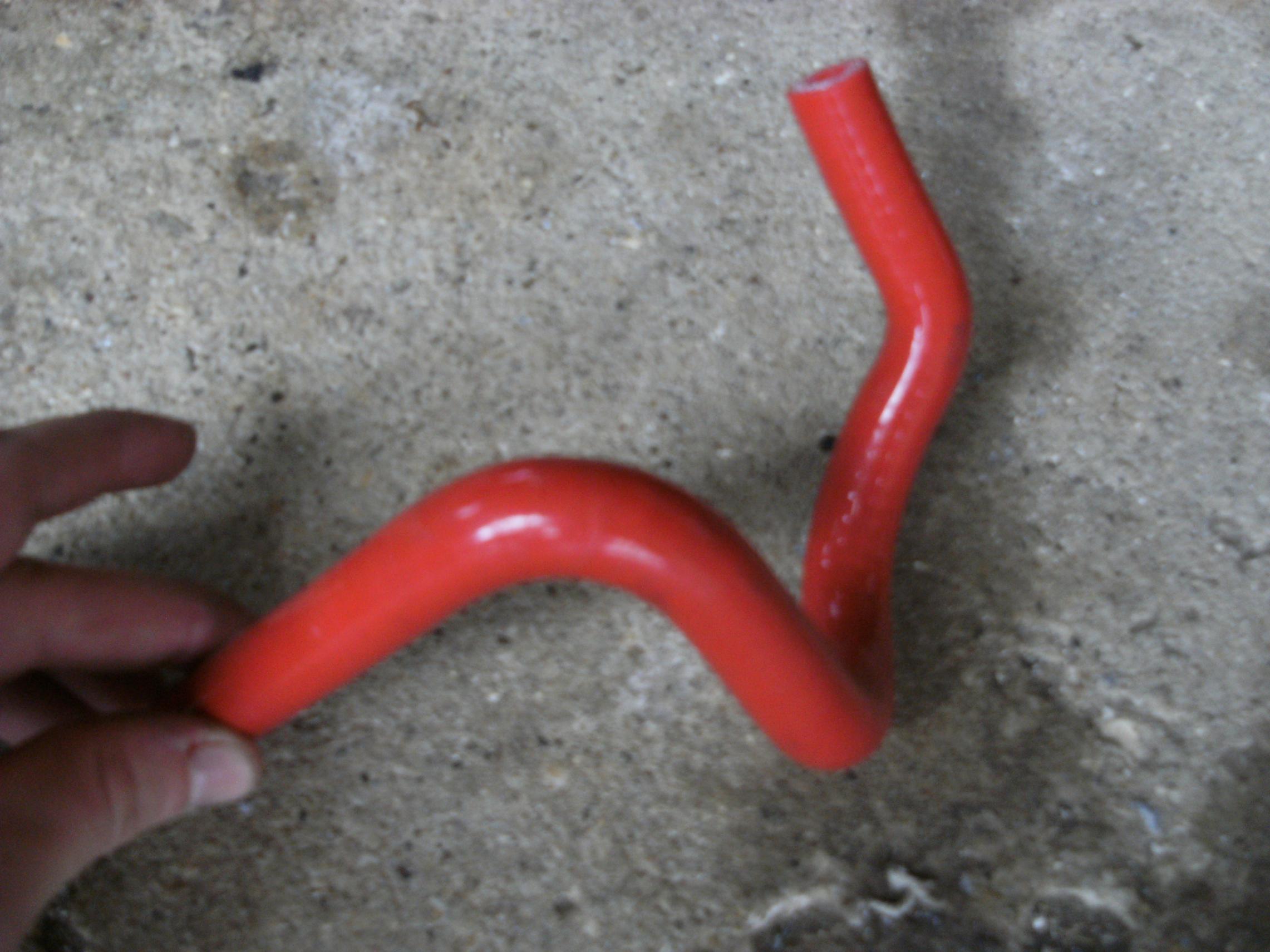

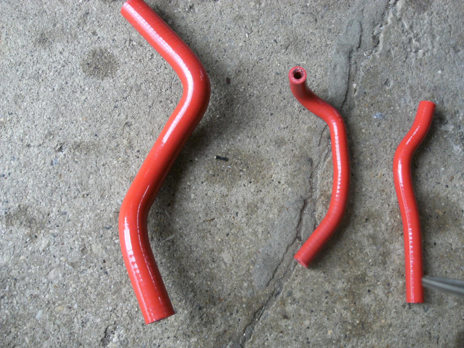

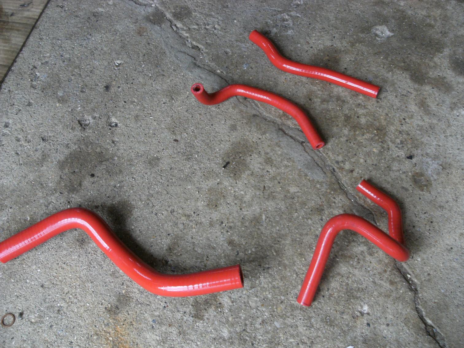

thanks i will try the bolt. I was also wondering if anyone could help me identify what these hoses are and where they are located. i cant seem to find them. I thought i knew where one went but i dont think its right.
