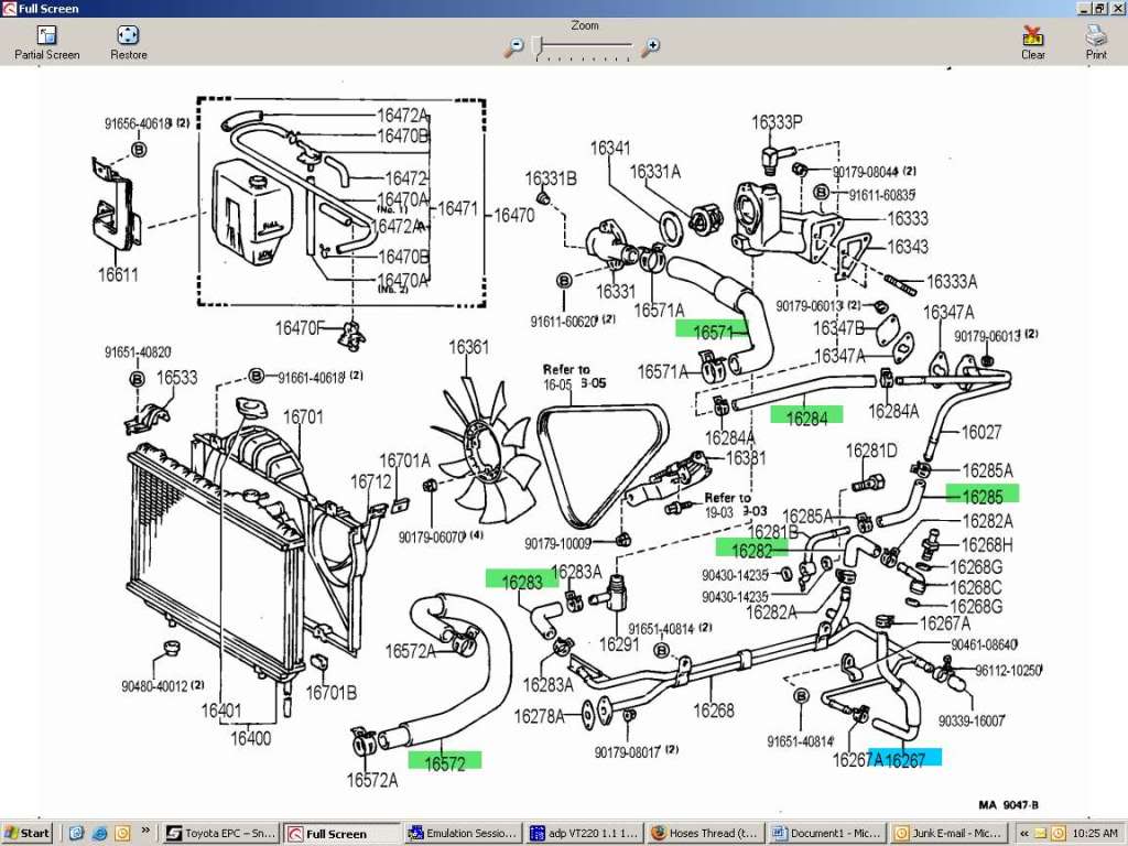

Maybe this will help...or scare you. It scares me..... to think of how many points of failure the cooling system on the 7MGTE has. Hope ya get it sorted out soon.

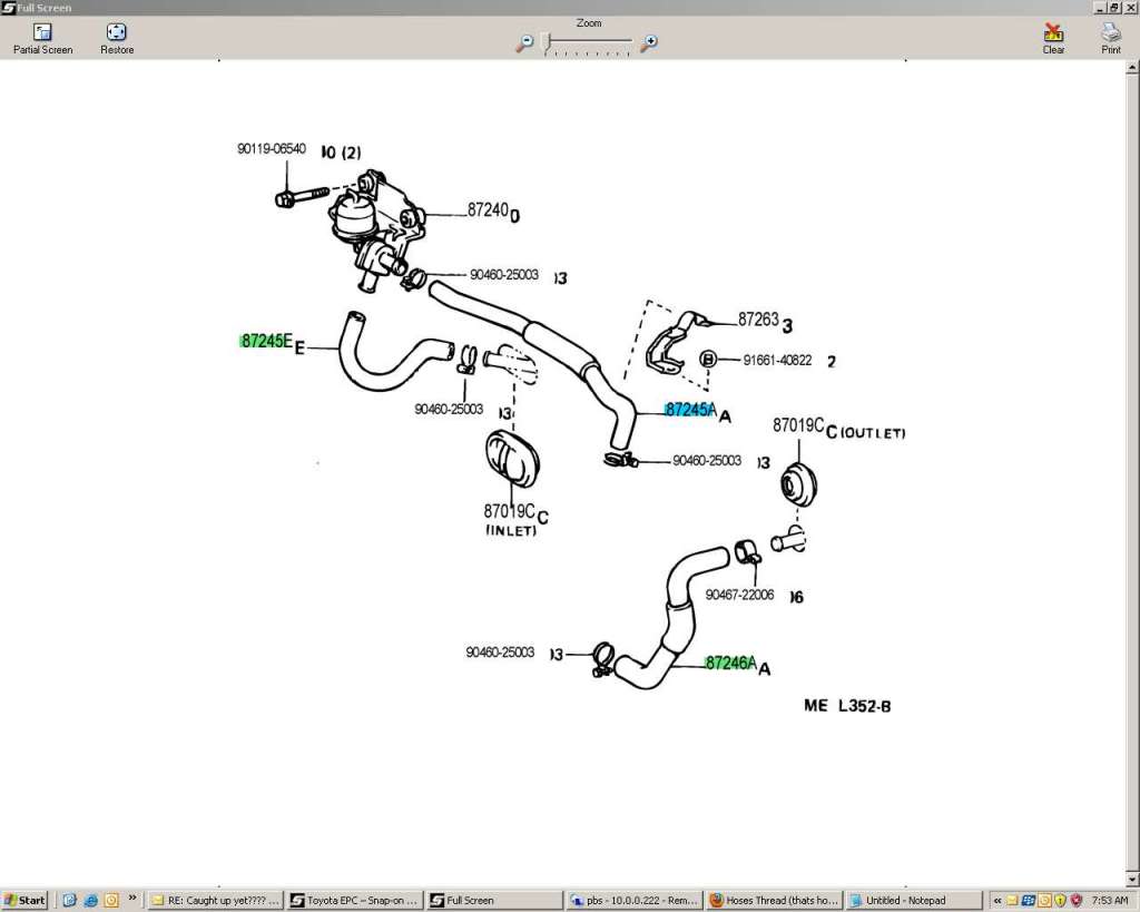

Don't forget this.
