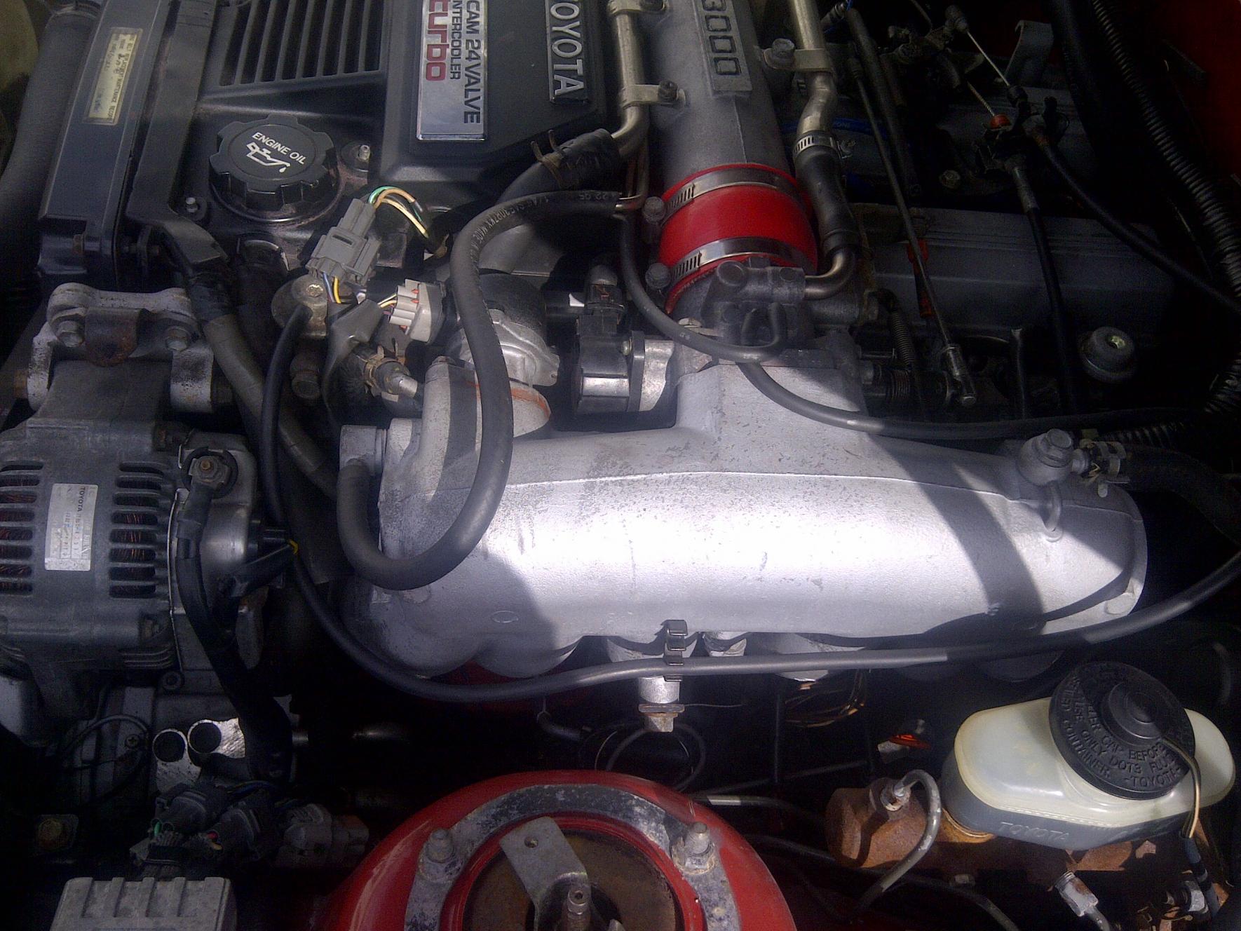

Thank you gents. Here are a couple of pictures of the car. As I mention I'm not a Supra expert so want to know if the engine and parts are stock..specially the thrttle body and Tps. The car according to vin is a 1990 supra turbo.

Looks like the stock throttle body to me.... Who told you otherwise? Post the part numbers already... sheesh.
