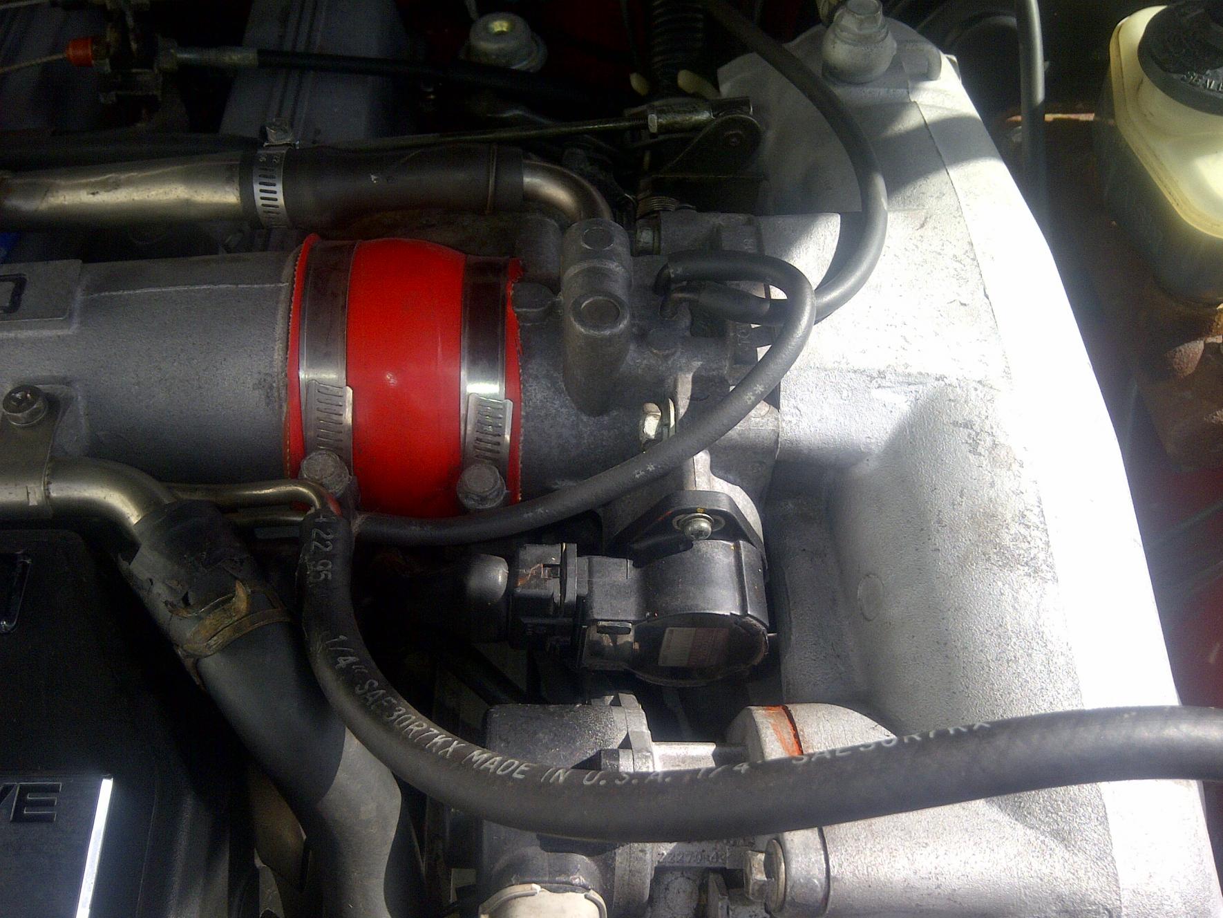

I bought a manual and I am doing a search on what exactly was done to this car. I will post pictures of the engine. I looked at the vin # and the car does have a turbo engine, intake is NOT a Y shaped. but the throttle and tps is of a non-turbo supra.

post a picture of the engine bay bro. your car is also Canadian. just an fyi

How'd you determine it's a N/A throttle body? The 7M-GE's throttle body from the MKIII Supra doesn't fit and I'm certain the throttle body from the 7M-GE from the Cressida doesn't fit either. The TPS would be fine though as long as tabs which mate with the throttle body line up... there was a mid year change where those were rotated 90? and that's not compatible, but that's not a GE or GTE thing.
Post the part numbers off of the throttle body and off of the TPS please. BTW, the MKIII 7M-GE's TB is LONG.

Thank you gents. Here are a couple of pictures of the car. As I mention I'm not a Supra expert so want to know if the engine and parts are stock..specially the thrttle body and Tps. The car according to vin is a 1990 supra turbo.

Looks like the stock throttle body to me.... Who told you otherwise? Post the part numbers already... sheesh.

I did some manual reading so i now know somethings about my supra. In regards to the idle problem, I bought a new TPS and it fixed the problem. My main concern now is the car stalling without notice. One of the codes shows a bad AFM.. what are the symptoms of a bad afm?. want to make sure before I make a costy purchase.
