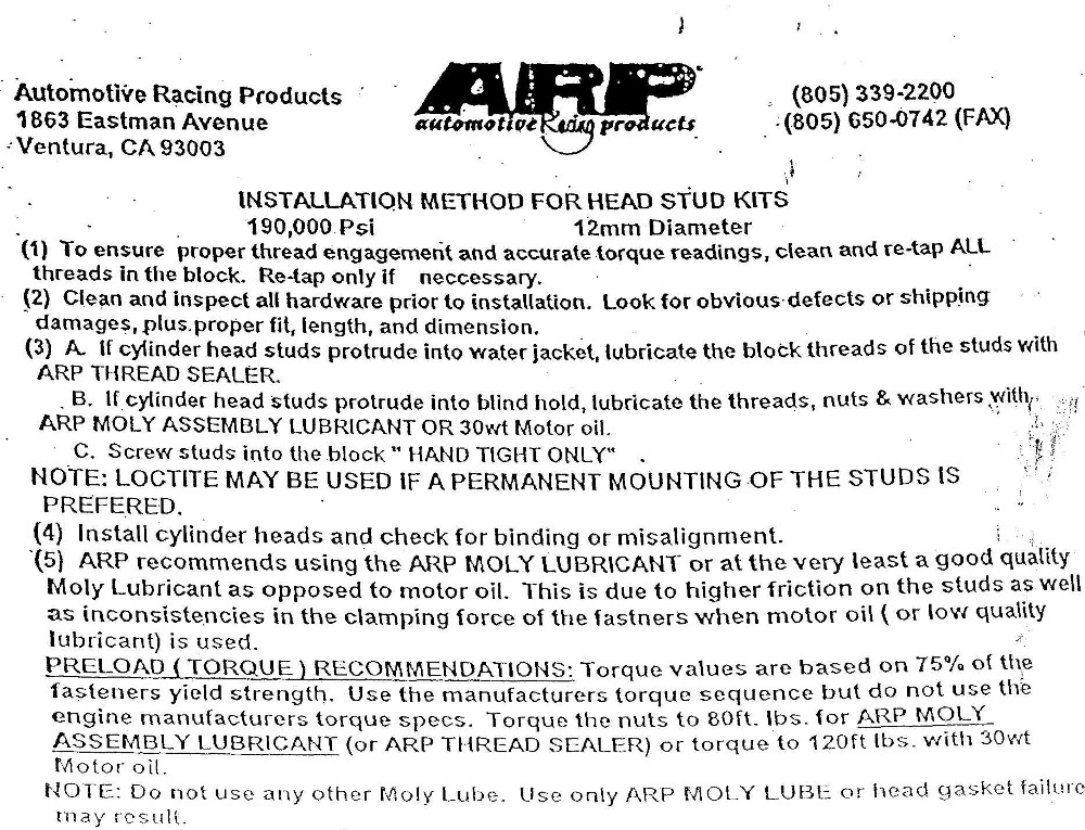

That measurement at the site you linked to is FOR STUDS (which have a much higher torque than bolts):
80ft lbs with moly, 120ft lbs with regular 30wt oil. Here's a scan:
Name:	ARP Head Stud Info Rev.jpg
I'll look to see if I have one for bolts lying around when I have the time and think on it.
Now if you're saying 115ft lbs when using oil you need to specify; ARP bolts come with much better lube and as such if someone doesn't understand and torques to that level they will destroy the fasteners and risk damaging the head.
Old 04-04-2011, 03:17 AM   #17
I belive when I put in my in my arp head studs the spec was 90ftlbs, and the studs have a higher spec than the bolts do.
Yeah, I thought studs were 90 too... I'll look for another instal sheet for studs, this one was posted by another MKIII owner and he says it's from his kit.
