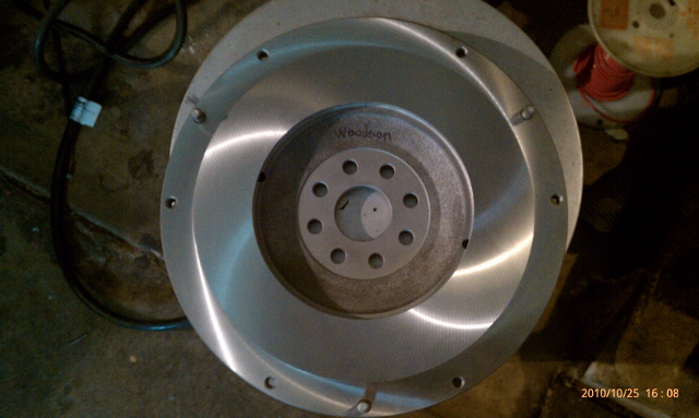

soo btw, i received my flywheel
ima post a pic up tomorrow becuz for some reason it doesnt look right, but idk haha
or maybe you can answer right now...
THERES A BIG ASS HOLE,
like you know how the center of the clutch disk and pressure plate is a small hole?
well this is a hole almost as big as the flywheel itself,
is that normal?
(i never seen a flywheel before)
cre 03-08-2011 12:04 PM
WTF? I'm going to need a picture of this. The hole in the center is only a few inches in diameter. Is this a new flywheel or used? Aftermarket or OEM?
ochowdero 03-08-2011 06:09 PM
its aftermarket, but oem replacement
its not the original, but its built to toyota specs and built stronger..definately not lighter, i think this thing is 13.7 pounds or something

i put it against the clutch disk and p-plate and it doesnt look right..
Travis89Turbo 03-08-2011 09:01 PM
That is not the right flywheel. I dunno how the hell that thing would work at all on anything.?

cre 03-08-2011 09:37 PM
No idea what the hell that might belong to...

907mge 03-08-2011 10:52 PM
Yeah thats not the right part. I wonder what that is for and how it even bolts to a crankshaft?

ill answer the question of what this thing belongs tooo
a frikin volkswagen -.-
the auto place sent me this, i cal back and argue that i order the flywheel along with my clutch kit for my 87 supra, and they say no we dont even carry the 87 supra flywheels! i was like wTF?
