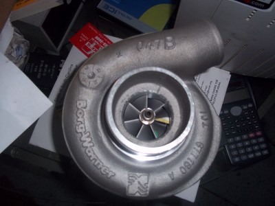

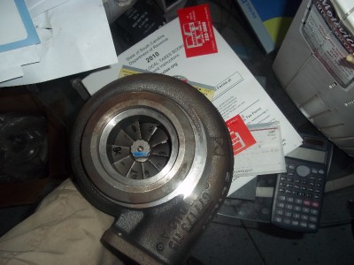

i found a borg warner turbo with any shaft play and no ding on the turbine, it looks bigger than my ct26. it has a lot of numbers arownd it but i dont know how to verify the specs. its made for john deere. it looks pretty nice and i will like to know if it can be use for my car. please if you know about it , reply. how can i verify its on good condition without having to installed yet. looks very clean and it can be use. thanks

ok , i was surfing the net and found this specs. its a model #177262. wheel dimension; 70mm exducer , 46mm inducer , 43 trim . and the housing A/R: turbine 1.15 , t4 style and 4.21" v band discharge. thats all that i can find. please help me telling if it works for my car. 1987 turbo supra, with 550 injectors , lexus maf , 3" exhaust , bigger intercooler , and a few more things. THANKS
these are pic that i found about it. the difference is that mine says John deere on the cold side. but its the same parts number

It's a pretty big holiday here in the US (figured you'd know that).... lots of us have stuff going on all weekend and are only checking in with our cell phones.
At a glance I'd say it's not going to spool nearly as quickly as it did on the truck you pulled it off of.... if you've got time it should do well.

ok thanks , 70mm is too big ? whats the perfect size for my settings? thanks for the help. i will love to get a garrett

The shift in sizes are one factor but on top of those that A/R is going to make for some slow spooling from what I know. Calculating turbo flow and efficiency aren't my thing though so a second and third opinion would be a good idea. The CT-26 A/R is about .49 though.... it the inducer and exducer were the same size as the CT-26's it would already be a lot slower spooling.... more power potential with the larger wheels, but with the time it's going to take to reach its potential will you be past redline?
