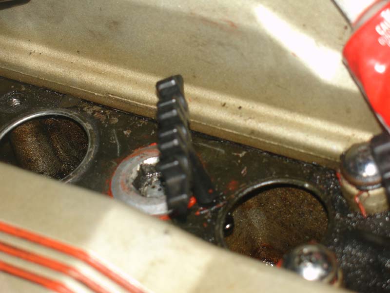

Thanks to all you fine fellas for all your Help. After days of trouble shooting I have found my problem with the Red Supra. The only reason I am posting this is because so many said they had never heard of a timing belt jumping on one of these cars, well here one is! Just thought you would like to see it.
Things aren't lining up as they should between the cams and the pulley mark and the stripped belt is the reason why. It appears to be the original belt cause it is stamped Toyota in white. Teeth are missing and the belt is cracking badly. Check it out guys and gals! I'll have this old girl going in a couple of days now.... I hope....lol
