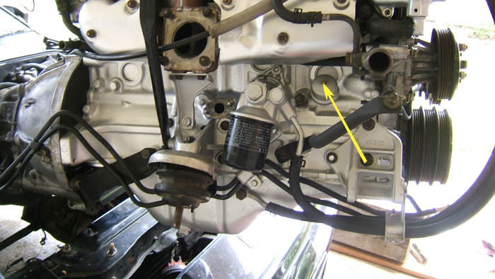

Off the top of my head possibilities are: knock sensor problems, AFM problem.... I'm not sure if the oil pressure sender being disconnected would cause that, but I think it's unlikely.
Did you get the knock sensors connected? Did you drop the AFM? Did you perhaps spray anything into the AFM (such as a MAF cleaner or brake cleaner)? Have you checked for codes now that the you've had the car running?
As for the oil pressure sender... Follow the yellow arrow.
