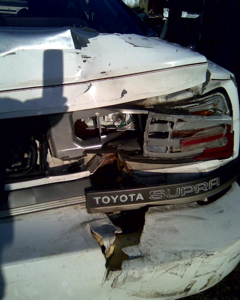

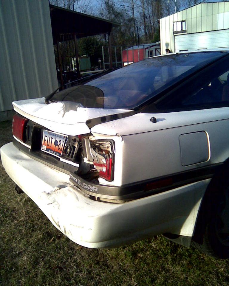

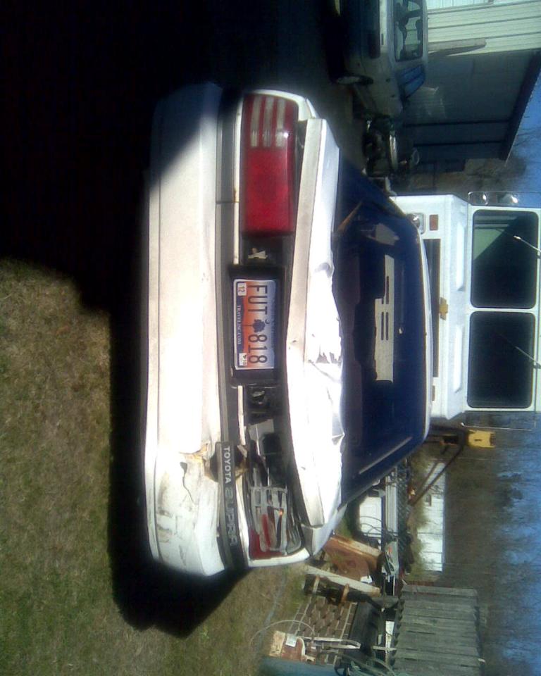

Is it worth repairing a supra that’s been rear ended or should I just take the insurance money and start over?
It is a little difficult to see from the pictures below, but the force of the impact buckled the quarter panel above the rear wheel, towards the door, and that makes me think the damage may be too much to fix.
I bought the 89, 7mge, auto, 160k miles for $700, 6 months ago. I put in $1400 in parts, replacing the head gasket, timing belt, radiator, drive shaft, differential, rotors, etc. After that, the car was driving very nice, thanks in large part to the information on this site, and answers to my questions from CRE, Bill UK, Dark Supra 2.5 and others.
A month ago I gave the car to my Nephew, who lives in Sumter, South Carolina (i live in NJ). He loved the car and all was well. A week ago, the car was rear ended by a pickup truck, while sitting at a traffic light.
The driver of the pickup received a ticket. My Nephew was not at fault, according to the police record. My Nephew had a stiff neck and drove the car home after the crash.
The body shop estimated it would cost $3,200 to repair the damage, using junk yard parts. The insurance adjuster looked at the car today and said its totaled, and would give an amount next week. My guess is they will give $2500.
Considering the money and time put into the car, is it worth fixing? I imagine the rear end and quarter panel will need to be cut out of a donor car and welded in to make the repair. I guess we’d end up with a salvage title, and cosmetically the car would not be perfect, but it seems like drivability would not be affected, since the impact probably did not affect the suspension or the engine. Are there any other options to consider other than scraping the car and starting over? Any ideas are appreciated. Thanks.

At a glance I don't see what's going to need welding. I can't comment until I see a LOT more pics. Pull the lamp fixtures and see how badly damaged the metal behind them is. It really looks like the hatch took 90% of the damage. If so, used +89 taillights = $125, used read hatch from a salvage yard = $80 (if it includes the glass, $40 without), used rear hatch latch and lock = $40, used rear bumper skin reworked to look brand new = $400 (find a used white one and you're set for $100 or less)... This depends on any other metal damage though.
I'm not an autobody specialist... I've just had to learn how to get by without paying one.
Post more pics, I'm sure someone here might be or know someone in the business.

If the buckle in the sheetmetal up by the passenger door happened as a result, I'd buy a new chassis and swap whatever's good into it. How's the rest of the car? (Including old dings and scratches)

Thanks CRE, for the thoughts. Yes, the buckled metal above the wheel was due to the crash. I guess your suggesting finding a new chassis because the damage is severe?
