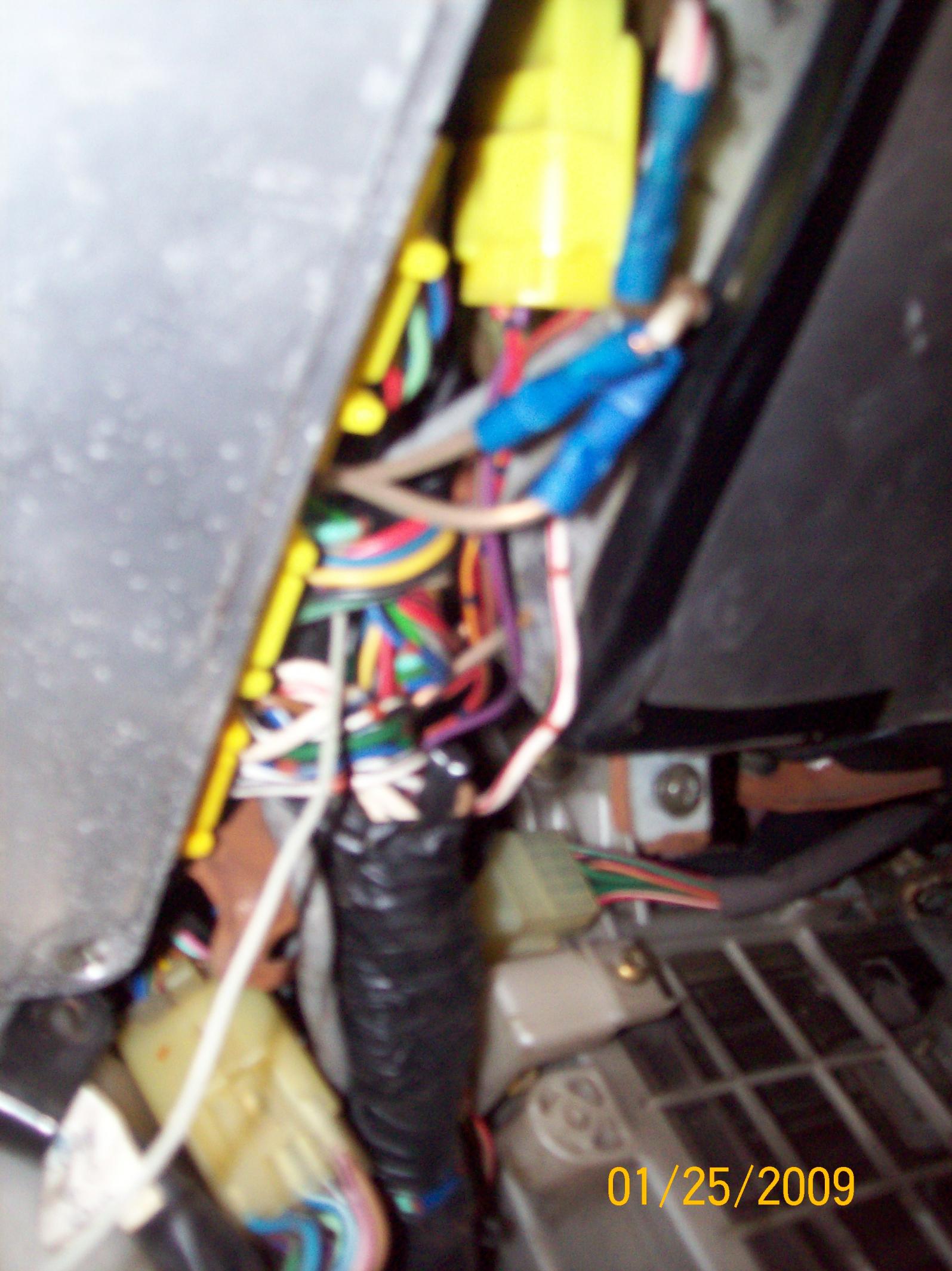

I got one for ya!!!! I beleave these are the knock sensors. one was hooked up and the other wasnt btw this is telephone wire going to them.
i noticed it last night and damn near shit due to the fact my ka-t wouldnt even run with the knock sensor unplugged..

And look at the ecu, the wires from the knock sensor are spliced right into the ECU terribly!!!??? WTF? who ever did this makes me sick.

A rewire is a commonly needed thing with the knock sensors.... although you need to use shielded wire. I'd rewire those and use some RG-58 coax cable. This replaces the old wiring and adds a grounded shield to help reduce interference.
Writeup and detailed info:
http://oldschool.supracentral.com/htm/knock.htm
Be very careful when working around the knock sensors, Toyota wants a LOT for new ones.

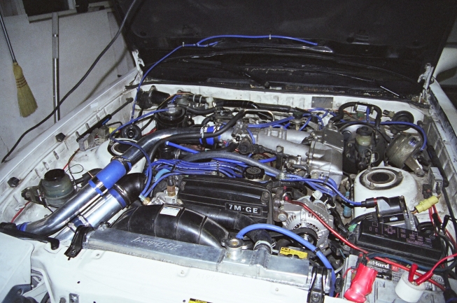

Here's a somewhat recent picture of mine:
