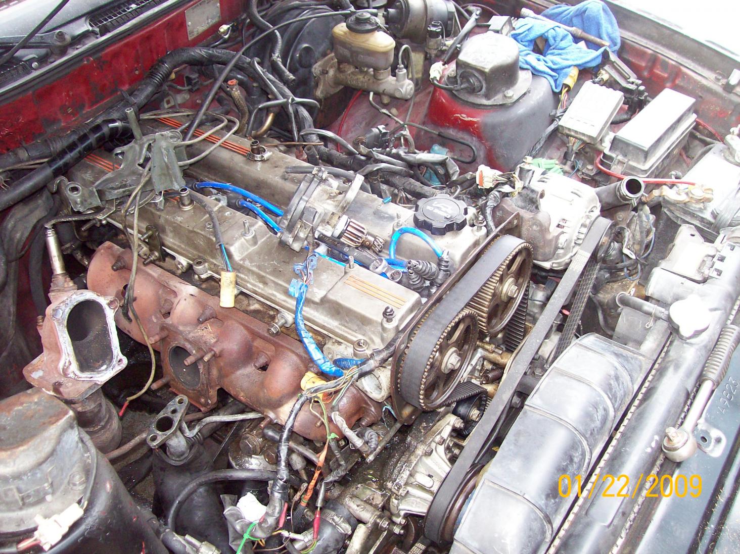

5 Attachment(s)
See thats what i want to hear. thank you man. i really apprechate the advice. i got the turbo off, and i got the bolt through the top :naughty:. and some other stuff. so far so good, its 12 pm here in florida and buot 60 degrees out so its a nice day to work. i think to days the day i get it off check out my progrees so far. OH and i installed my new supra mk4 TT seats in last night with my new profec boost controller. check it out! lol,

As you can see i had massive amount of oil in my intake. hoping i blew my turbo and its not blow bye lol.
MA70-3.0GT 12-06-2009 05:40 PM
You're getting close now, with the turbo off & inlet mani' out the way you're on plain sailing from here. Just make sure you undo the head bolts in 3 passes & in the correct order (opposite order to tightening sequence).. I'd say maybe an hour until the head's off now.
Oh, make sure the drain plug's out of the block too or water can get into the oil passages!
As to the oil, it's normal to have some oil in the intake but if you think it's excessive (only excessive if the car's visibly blue smoking IMO) then you might want to check the turbo oil drain isn't blocked with carbonised oil caused by shutting off without warming down. TSRM has specs for measuring turbo shaft play too.
Best of luck & let us see the carnage of the old HG when you're done! :naughty:

Lmao! im undoing the timing belt now. im gonna find a ziptie and squeeze the two togeather at the bottom so it doesnt loost a tooth in the belt from tdc. the guy i bought it from said he had a hks mhg so we'll find out. still so nervous.
Oh and...
MAN is it nice out... :grinking:
lol, so you want me to drain the oil too? not a big deal but my car is pretty slammed... lol. thanks again bud!
