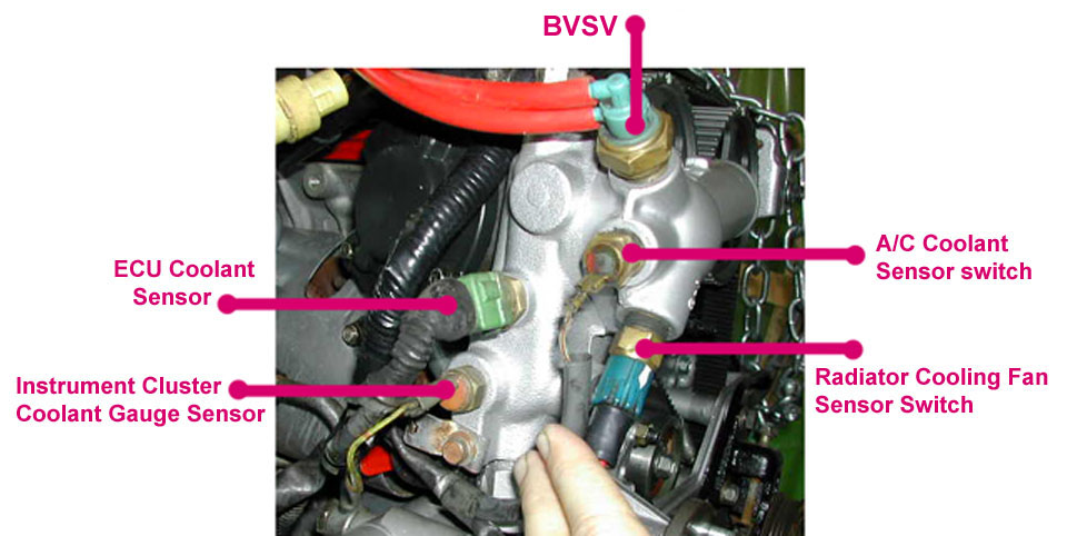

That burning coolant smell means you're loosing coolant and it's most likely hitting the exhaust. The ECU coolant temp sensor is not the same as the gauge's temp sensor... they each have their own.

Hmmmm, that picture is VERY helpfull... apparently what I did fix WAS the ECU sensor... which explains why this wanting to die out feeling when the engine is cold just began when I fixed that. I'm honestly hoping the BVSV is for a blow of valve because I have nothing at that point, the two green things the orange hoses are hooked up to terminate right there... no hoses. Guess I'll have to check the gauge sensor when I have light tomorrow...
As for the burning coolant smell, I actually smell it up near the main hose connecting the thermostat to the radiator... and to the right side of the radiator, close to the front right headlight... don't think I'm loosing coolant tho as my level in the radiator is at the cap any time I check it cold, and the overflow isn't boiling or filling up when I check it hot. I've just assumed the smell is coming from the hot coolant being pushed back into the radiator since I have no fan shroud and the water is probably not cooling as well as it should be... believe you me, once I get all my leaks and kinks fixed, an alum. radiator w/ dual elec fans in one shroud will replace my crank fan and radiator in there now.. but I guess I'll need to get a radiator for the transmission cooling too... dunno where that's gunna go, I've already got the one for oil? in front of my current radiator now.. Even worse, this car was a manual converted to auto... no, I didn't get that backwards... and I have no idea why someone would do such a thing... but it leaves me wondering if my radiator is cooling my transmission fluid at all as is.. :\

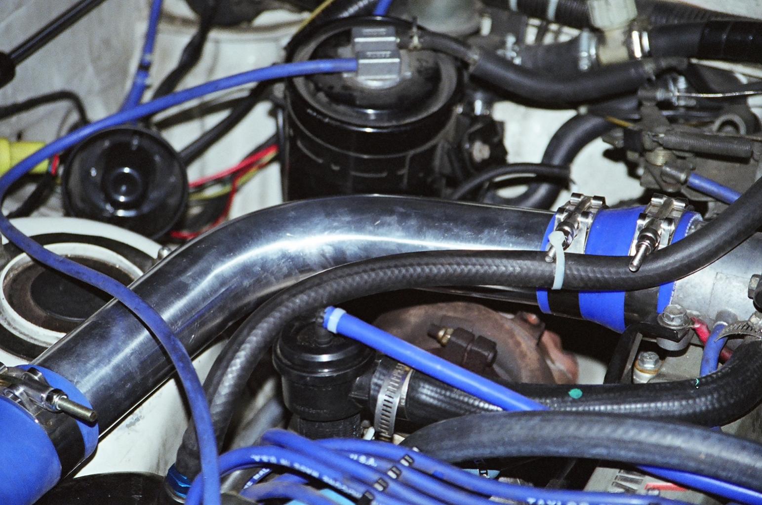

The BVSV is part of the charcoal canister's plumbing. The CC is the big canister right behind the passenger side wheel well (looks like a little black barrel with two nipples on top. If it's missing you should fix it, it serves much more of a purpose than some people seem to think.
Here, it's the black can in the top of this pic:

As for the Canister, I have that... two black hoses plugged into each end... not sure where one end goes, but the other comes back around and into my air intake tube.. reading the explanation of the EGR, this makes sense... but I'm just confused why the BVSV is on the thermostat housing if I can just plug the purge to my intake... I can't wait to get some pics to post... would make this much easier, and I can show of to my friends that aren't local

As for the CC, the proper routing is for the purge outlet to run to the upper nipple of the BVSV and then from the lower nipple of the BVSV to the throttle body. Running it directly to the throttle body puts the CC under vacuum all the time which isn't really something you want as it route back to the gas tank (which you don't want under negative pressure as much as you don't want it under positive pressure). The way you have it routed right now is fine for a temporary measure if you BVSV is broken (it's not uncommon for the nipples to break off when they're this old). But it can also contribute to excessive richness in the air to fuel ratio.
