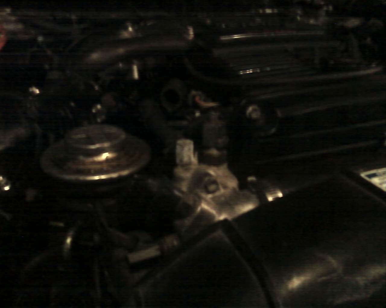

hey so i've had a jdm engine installed by a motor shop here in ottawa and i have some interesting questions, first of the car is a 89(newer style) but the engine that i acquired is from a 91 auto jdm, now it's been running fine until i decided to check up on my vacuum lines, for sum reason my bvsv(whatever that is) is not on my thermostat housing but rather an electronical device is in it's place? all pictures i have ever seen indicate there should be some vacuum lines there, the company custom build a wiring harness for me as it was chopped near the block. but i still have the 89 ecu in the car and as mentioned you guys were talking about the different impedence injectors on each model, is there anyway i can check if my setup is ok. thanks for your time

The JDM 7M's have all the same equipment except they do not have the EGR system (they should have kept it as it creates lower combustion temps and thus you can apply higher boost and advance the timing even further without knock!) and I believe the oil pressure sender is different. If you don't have the BVSV or charcoal canister I highly recommend you repair/restore that system. It serves a few purposes, the pressure regulation helps prevent the fuel pump from caviating (deteriorating) and also from working harder than it needs to.
The sensor locations didn't really change just one spot was added.
Here are most of the ventilation and vacuum hoses; the only ones you probably aren't going to have are the couple used for the EGR system.
http://www.cygnusx1.net/Supra/Librar...spx?F=1201&P=2
http://www.cygnusx1.net/Supra/Librar...spx?F=1708&P=3
http://www.cygnusx1.net/Supra/Librar...spx?F=7701&P=2
Heater VSV and Control Valve:
http://www.cygnusx1.net/Supra/Librar...spx?F=8717&P=1
EGR; if your EGR system is present you'll see these components and you'll find the vacuum lines in the first diagram above.
http://www.cygnusx1.net/Supra/Librar...spx?F=2501&P=1
If your sensors are in different locations you need to make sure they're all at least on the correct side of the thermostat.
The injector impedence is an N/A only thing... unless you're putting N/A injectors in a GTE it has nothing to do with a GTE their injectors were the same. NOTE: If you are, for some bizarre reason, wanting to install N/A injectors in a GTE you need the YELLOW topped (see: low impedance) injectors.
Post some pictures of the things you have questions about and I'll see if I can be of assistance.

thanks for some of those helpful hints, well all my vacuum lines are hooked up except for in the picture you can see that i dont have a bvsv with two vacuum ports, instead rather it has an electrical plug. the vacuum line has simply been directed to the charcoal canister from the port on the metal line coming out parallel to the intake. could this possibly be because it's a 91 engine? and also i haven't tested the wires but i assume they are operational even considering im using a stock ecu. and i apologize if it's a fuzzy picture shity camera.
