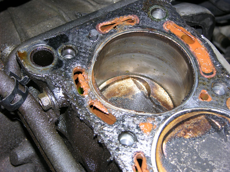

I'm in the middle of a 7MGE rebuild (you can check out my thread on this form) and have learned not Head gaskets are alike. The factory gasket that lasted 20 years had copper crush rings around all the water ports. I purchased a complete engine rebuild kit from the shop for $200 and the head gasket did not have the same crush rings as the OEM

So I checked out the gaskets from CAR Quest and NAPA and they all have the same OEM crush rings at $85 for just the gasket. I am going to toss the one from the kit and pay the extra $85 since I don't want to do this job for another 20 years.

Good idea... always inspect your gaskets before you install them. As you correctly assumed, those crush rings are there for a reason. Have you checked out how much a Toyota gasket will run you? If it's just a little bit more, that'll be the way to go if you don't want a metal one

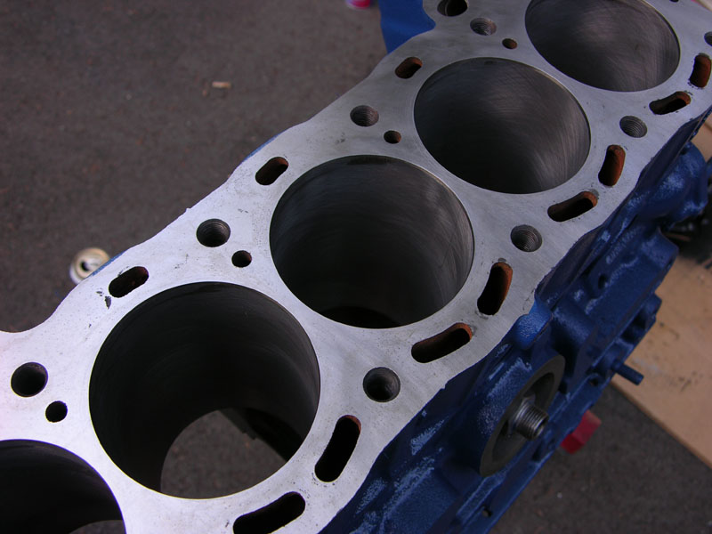

Don't metal head gaskets require a perfect finish on both the block and head to seal correctly? I had my block out so I could have the deck shaved and the shop still would not recommend going to a metal head gasket. Seemed that over the years water/coollant eats away at ports so that even a good shave will not it get right.
before block prep

after block shave

Unless you going to remove the engine block grind the block deck to perfection - i'd go with a composite gasket. It will be much easier and last 20 years
