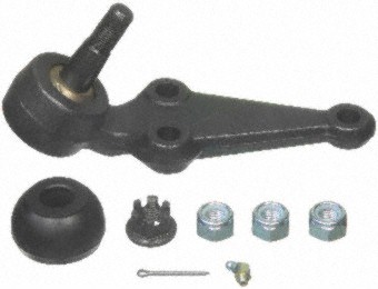

Here is the ones I used, from Carquest, made by Moog (been making front end parts since forever).
LOWER BALL JOINT
87-92 CCH K9521
List $105.40 Wholesale $52.70
