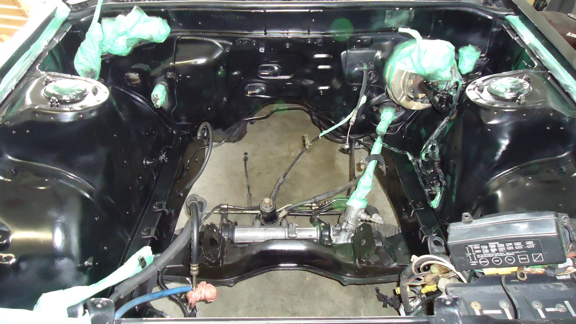

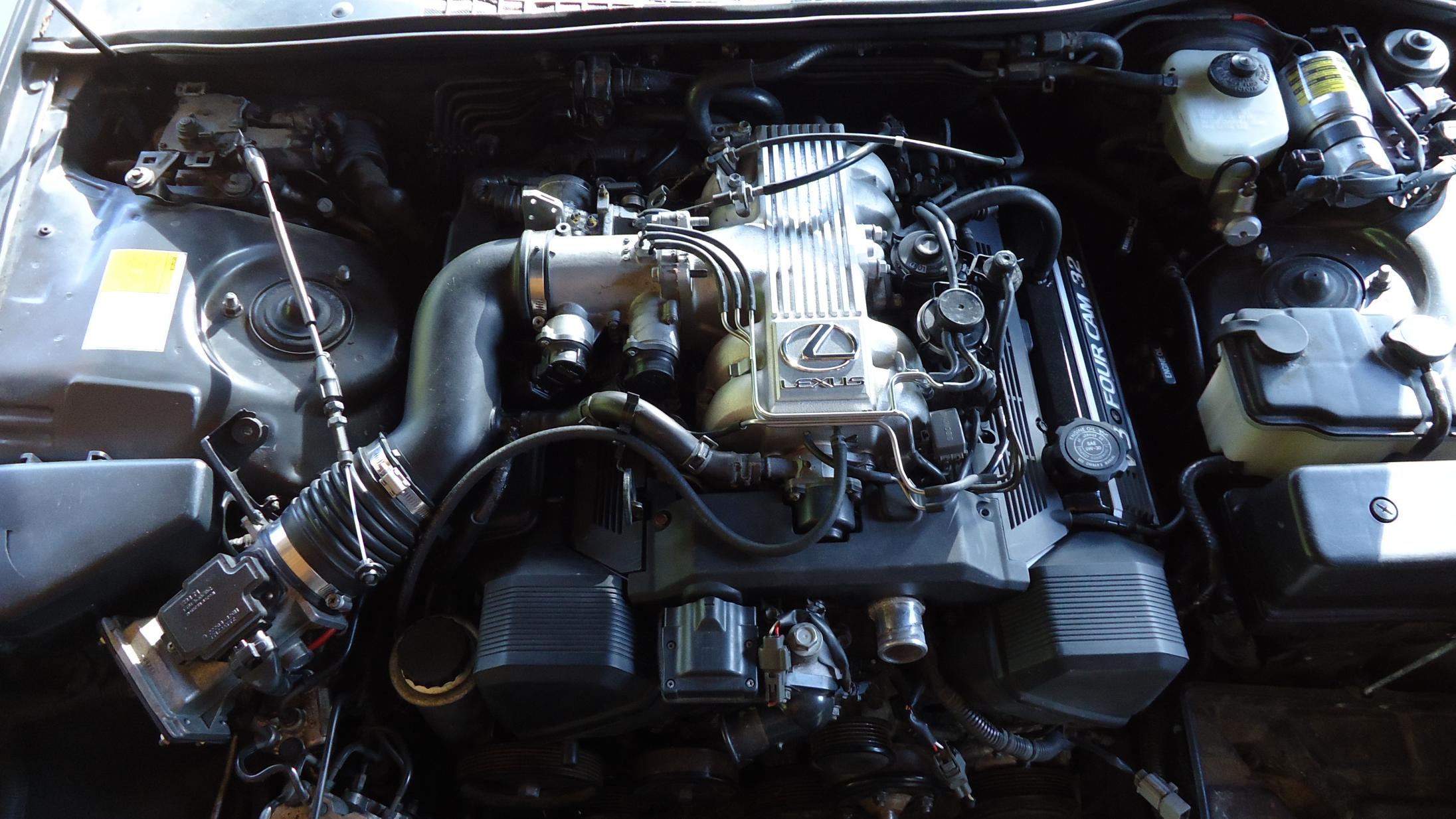

gona throw some green in there because i can...
CanadianBak'inSupra 10-01-2011 06:32 PM
1 Attachment(s)
Attachment 4242
all clean and painted up:bigthumb:
