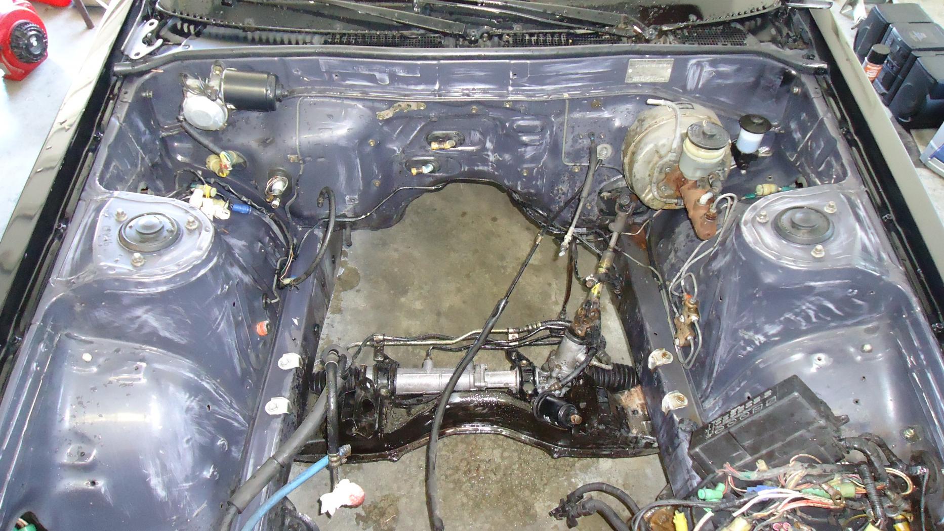

my engine bay is almost ready for paint. hitting it with a scotch brite some more.
gona paint my trans. black aswell, my adapter plate was sent out on 22nd so it shouldnt be too long for that.. |

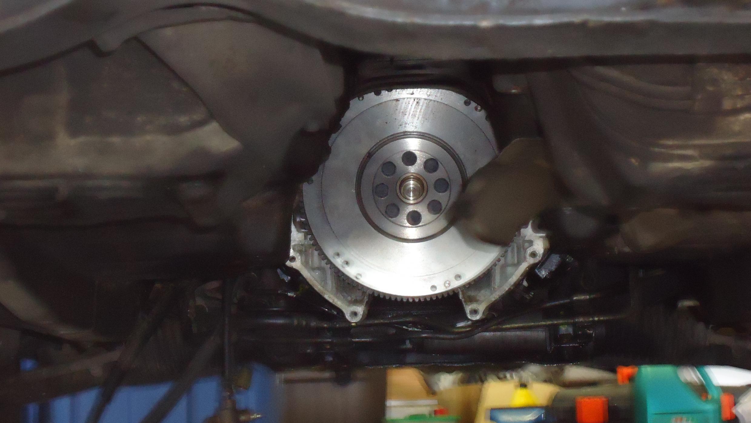

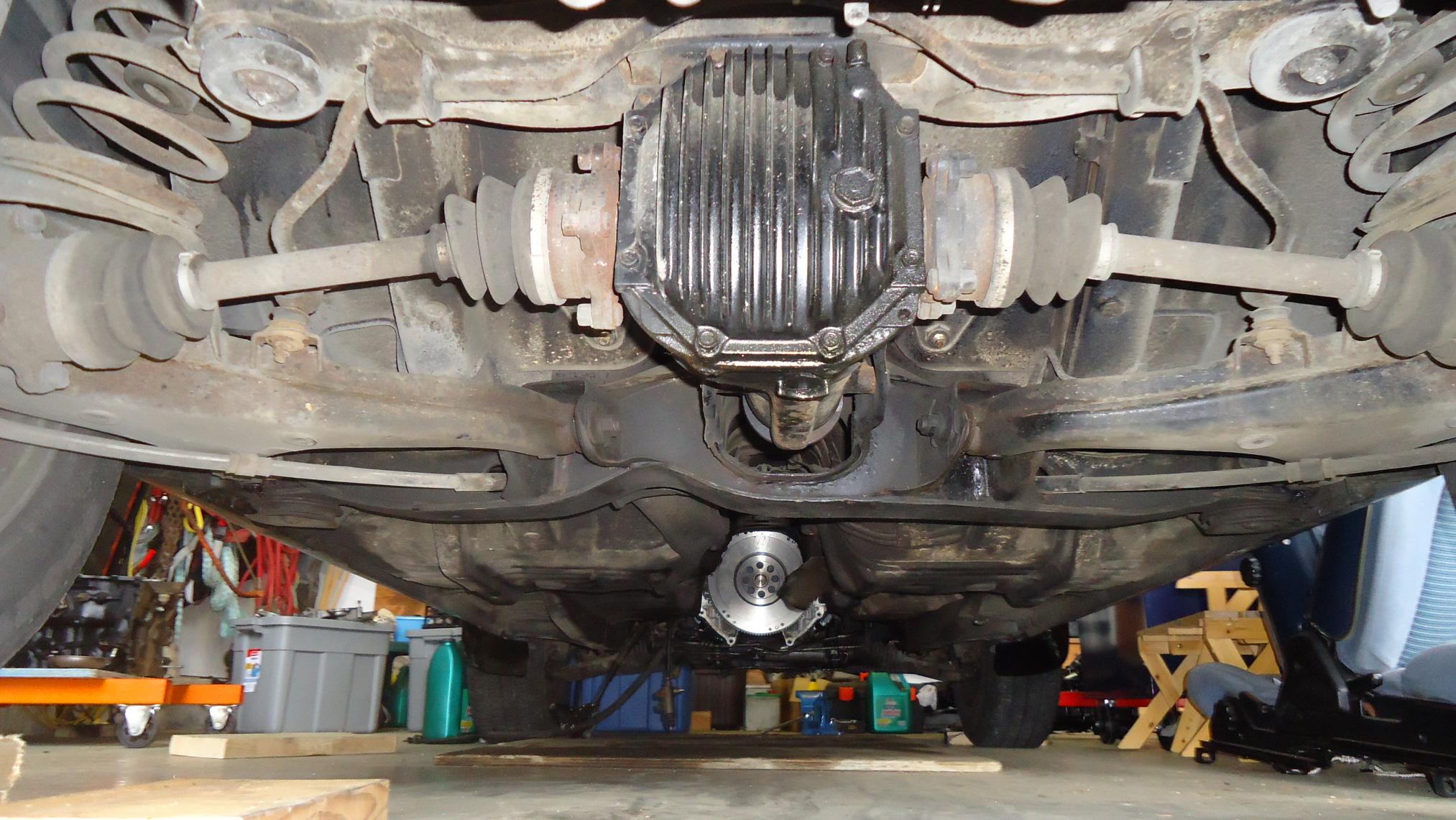

1 Attachment(s)
flywheel came in for the 1uz. didnt think it was ever going to...
Attachment 4460 |
