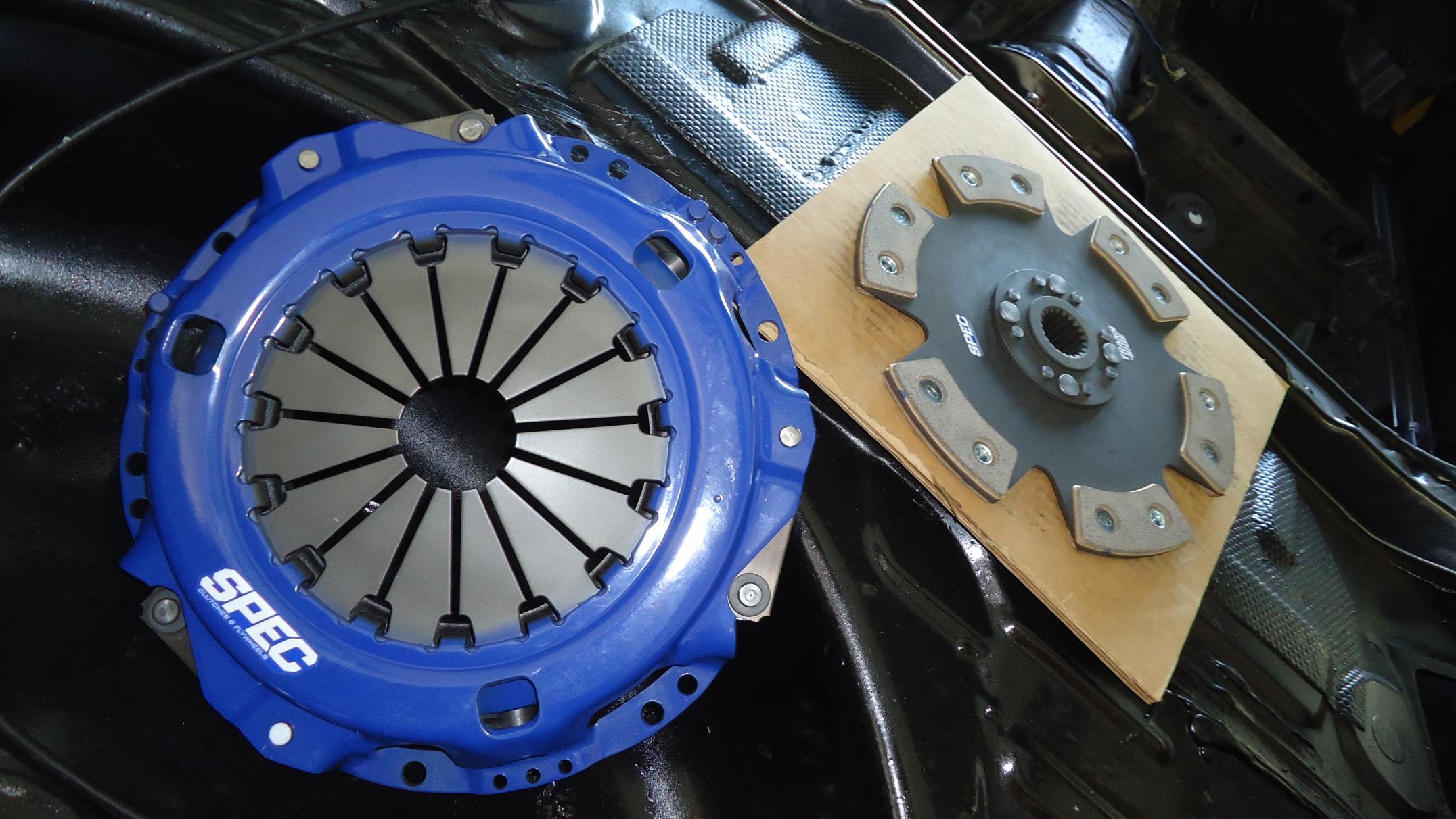

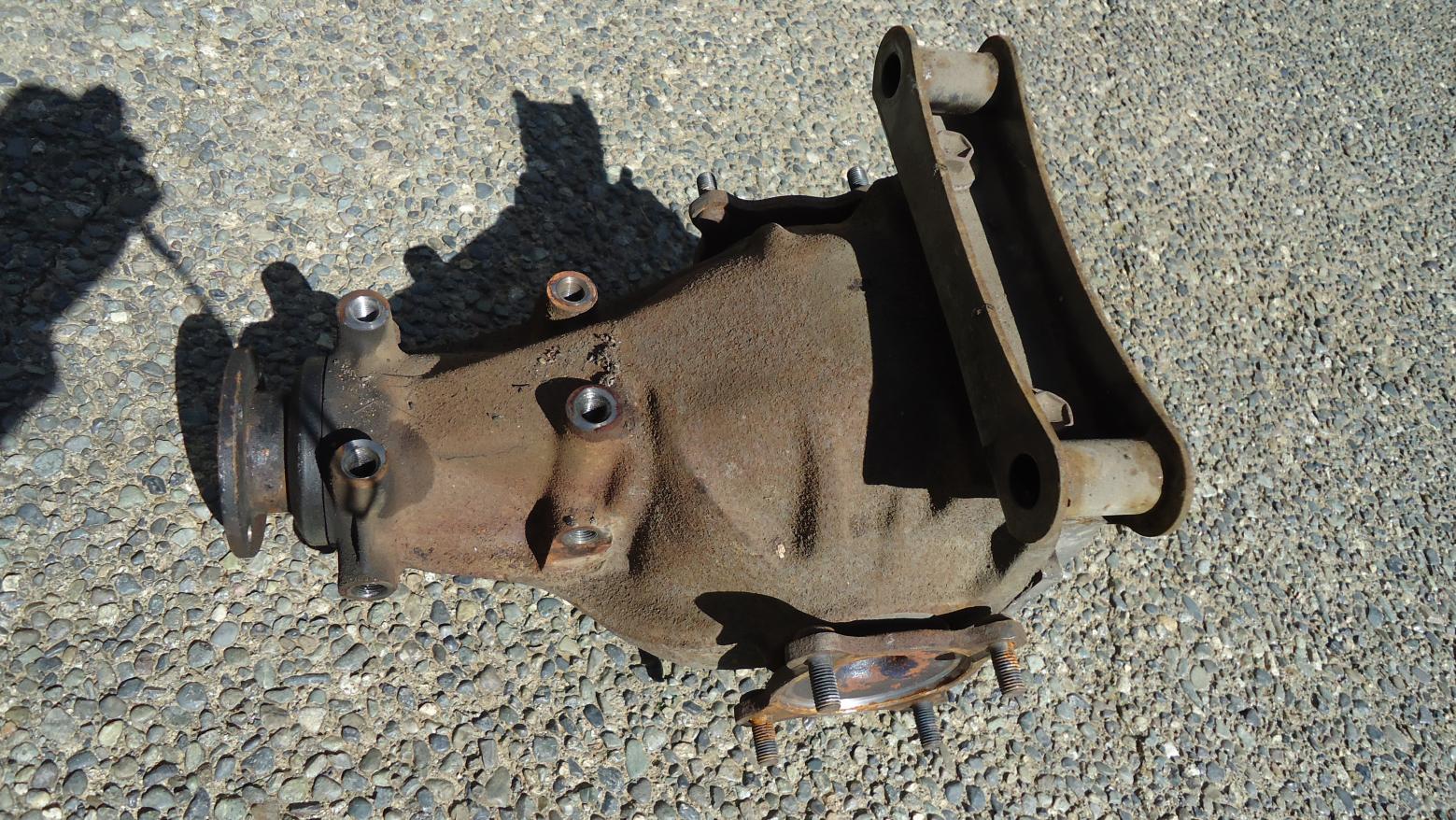

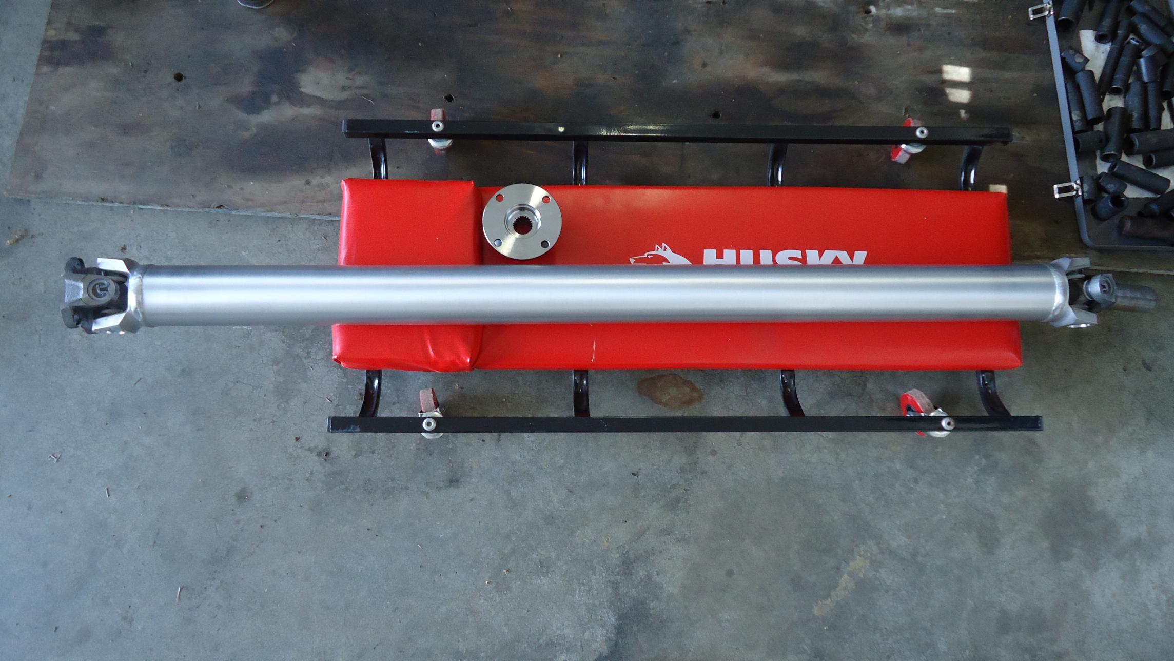

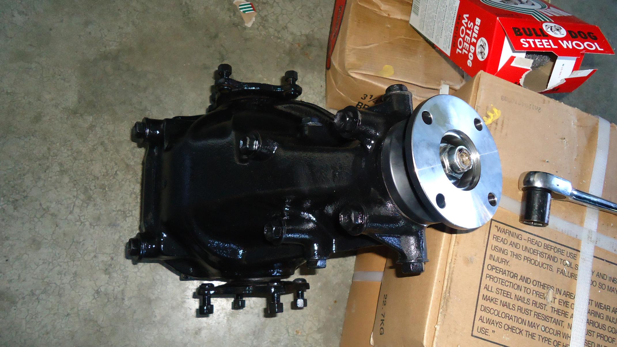

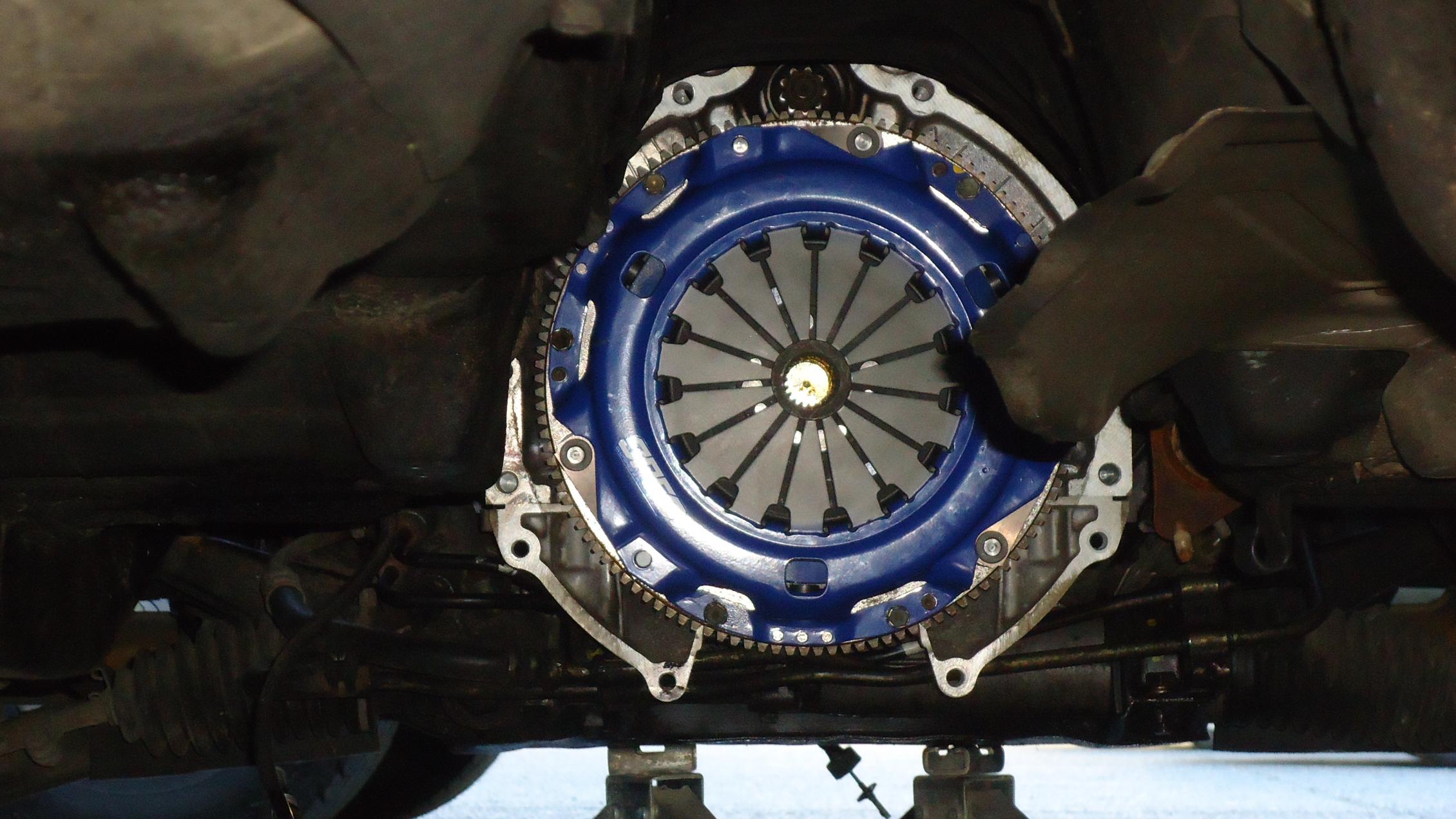

here is some shots of the final drive train install:
Attachment 4813
before:
Attachment 4815
after:
Attachment 4814
Attachment 4816
Attachment 4817
