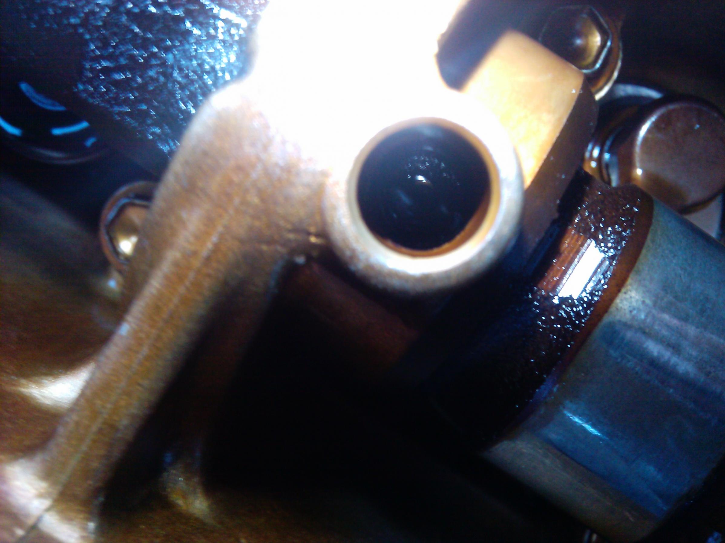

Here's some pics:
intake cam
exhaust cam
dizzy
Crank timing
I pull the timing belt back off and made sure everything was perfect with its timing marks but I noticed I couldn't get the timing belt on then.
