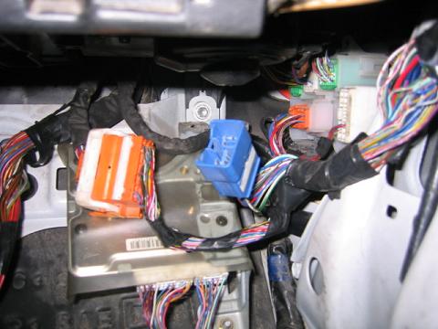

Can anyone confirm that my car is indeed missing the factory security ECU? If so is there a way to bypass this module so that it will at least turn over?
Name:	Supra plugs.JPG

Have you checked the wiring/electrical TSRM?

Yeah, I couldnt really conclude anything useful from the manuals since they assume the module is already there.

The manual describes all of the signals in the harness, and it should provide enough info to bypass. Either way, have you tried purchasing another unit (used or new)? I'm sorry to say that personally I've never tried to run an mkiv supra turbo without this ecu installed, so I don't have any quick-fix remedies/workarounds for you...

Its +12v to pin 25 and Im looking for a used module (I dont see the point in buying a new one when one of the first things the car gets is an aftermarket alarm).
