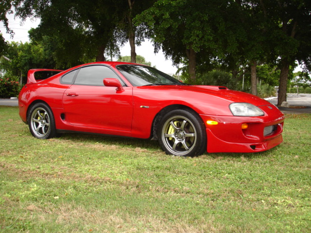

I would like to get a race style, all aluminum radiator for my Supra, but since it is automatic, Koyo, Fluidyne, etc (all rerquire a transmission cooler) I'd prefer to buy a direct fit that already includes the transmision line. Does anyone know of a radiator that fits these specs or should I just go ahead, bite the bullet, and add a trans. cooler? Toyota OEM wants $635. I would like to buy better for less. Any suggestions?

For what it's worth, I'd suggest you bite the bullet and add a trans cooler.
If you don't mind me asking, why are you looking for a race/aluminum radiator for an auto mkiv? Normally you'd only need that item if you planned to roadrace, which is rarely done if you have an auto.

I can get Koyo for about $339 on Ebay vs. $635 for Toyota OEM + my mechanic says you get a better cooling radiator (more fins per square inch) for less money, so its a win , win. Better, cooling radiator for less $$$, even when I add the cooler.
