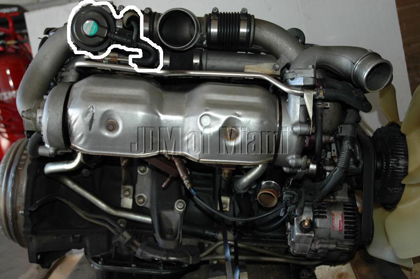

HEY WHEN I GOT MY FRONT CLIP AND SWAPED IN EVERYTHING THEY SEEMED TO HAVE MISSED A PART LOL... THESE ARE SOME PICS. NOW THE SUPRA IS ACTING A LITTLE ODD WARMS UP WHEN I GET IT ON THE FREEWAY GOING ABOUT 75. BUT DRIVING ALL AROUND TOWN AND PARKED SHE STAYS COOL. SO ANY THOUGHTS TO WHAT MIGHT BE GOING ON.. DOESNT PULL ANY WARM AIR THROUGH THE VENTS. LET ME KNOW IF THIS PART COULD BE THE PROBLEM AND WHERE I MAY FIND IT.. WOULD BE GREATLY APPRECIATED... IF ANY ONE HAS OTHER QUESTIONS FEEL FREE TO ASK.

That is the factory Blow off valve. Its all there all the vaccum piping is metal and underneath. As for needing it I have plugged mine off and gotten a aftermarket one because the factory ones are known to leak. As for the warm up how much warmer is it getting mine stays a constant through all driveing ranges and are you still running the stock hydro fan or a electric?

i was wondering if it was the BOV. it'll warm up all the way to about 1/4 inch beneath the H mark so i didnt wanna hurt anything so i would always back off when that happened.. its definitly not constant. it heats up on the freeway. i was thinking possibility with the turbos.. constantly spooling at a certain RPM and causing heat. cause when i coast.. the temp drops. sitting the temp drops of course the turbos in those cases arent spooling.. i have the stock hydro fan cause suposably they push more air.
