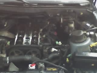

well heres sum pics of what ive got done. but ive got a problem. i cant get the turbo heat shield off due to a stripped 12mm nut that is hldin thew back part of it on. any1 know how to tackles this problem, ive been spraying it with wd40 forever and the 12mm just keep slippin off the sides...any advice?

You have a couple of options for your stripped 12mm nut problem. 1 is get a big pair of vice grips (locking plyers) and clamp that mofo on there REALLY tight. Might want to have someone strong clamp it on there for you if you can't. The 2nd option is you can buy a "nut buster", they are like $10 from the parts store and work pretty good, they destroy the nut, but at least you can remove the part and you can always go buy a new nut. I have one right here next to me and if you want I'll post a pic of it.
