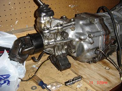

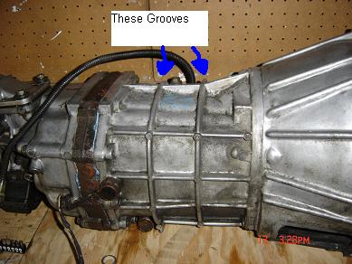

the brake pedal takes 10 mins putting the clucth pedal and master is a snap but make sure you have the clucth lines set up before you set up your master. i wasnt able to finish my swap but putting the pedals in were deffinatly the easiest part. (dont know how to wire them up) to figure out what trans you have look on top of the gear box and there are thoose grove things. mcompare them with this photo. this is a r-154 and it came out of a turbo supra.

if you want over 350 hp you want to get a r-154 (turbo) trans because it can hold like over 1000hp but if you dont want to go over 350 you can use the w58 (n/a) trans. the one in the pictures above is a r-154(turbo). Questions??

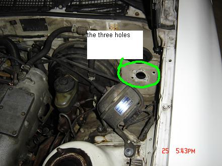

for the clucth pedal you need the bracket as well. if you look under the hood in the driver side corner you will see 3 holes 2 small ones for bolts and one larger one. when you have all the clucth lines set up you will be able to put in the master cylinder. you put it in place and then go under the dash and put up the clucth pedal bracket and put on the nuts and bolts and your done.
