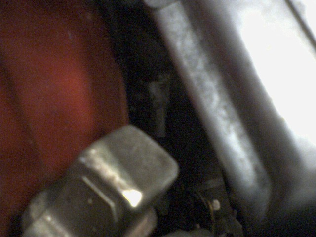

Now my questions, in the first pic (sort of unclear) there is a white wire connector attached to a tab on the side of the wheel well in the engine bay sort of below the AFM, and it is not connected to anything and I dont know what it should be. Any ideas? Second question, in the second pic is this little connector by the passenger side strut tower, same problem as other one, nowhere to plug it in, no idea what its for, any help please?
