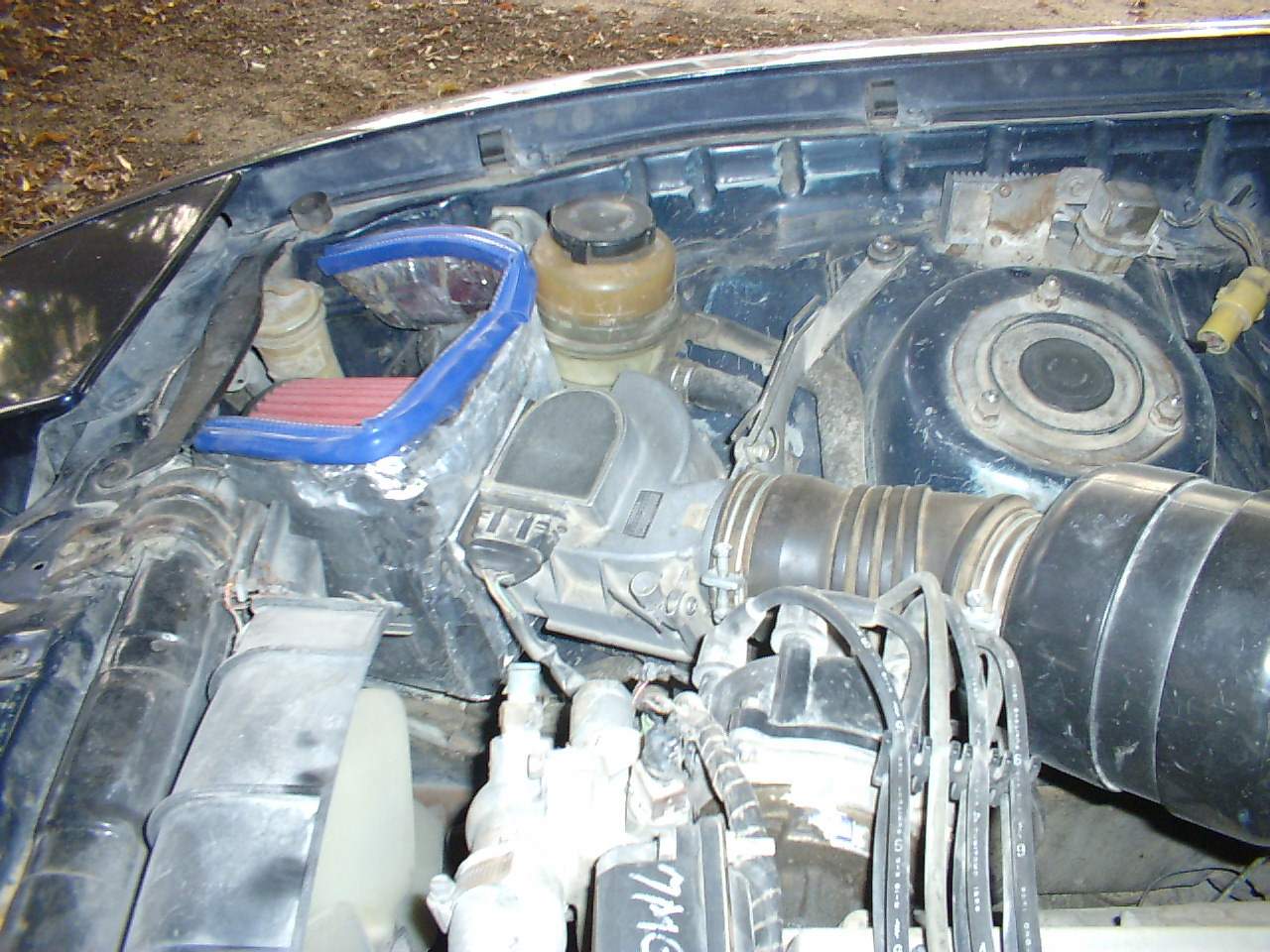

yo weezl this is thanx to you too i thinkis the final setup that i will use
sori for the pics (took it with a camera phone)
with this setup i also moved the afm, one good purpose is to free up some space in the front,
on the 1st pic
the red circle is a 2.75 to 3 inch coupler with a 45 degree bend
the blue lines is a 22 degree bend pipe from pepboys
cone filter from pepboys (i advice getting k&n filters, theyre better)

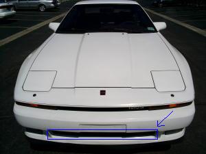

the green lines is a 2.5 to 3 inch coupler that i used to insert the duct that lead to the bottom front of the car
last one is a 3 inch plastic tubing pretty long actually it goes all the way down to the bottom slits in the front and i used some zip ties to anchor it to the bottom grill, if you are gonna do the duct too, u need to cut a hole in the plastic cover behind your fog light underneath the car
you dont need to disassemble your headlights either like S.O.G.I. said jus use the oblong shaped hole under the headlights, i think this is where the old inlet goes , so all this setup would coust u around 30 bucks pretty cheap for a cold air intake dunt u think?

Old 06-01-2006, 04:20 PM   #6
burton51m
burton51m's Avatar
Join Date: Feb 2006
Location: Canton, OH
Posts: 536
Question afm n things
couple questions...
1.when you moved the afm did u have to extend any wires or do any cutting or does it just move up there pretty easy?
2.the air duct...did that connect directly to your cone filter or is it sitting there?
3.is there a website to get the pipe from?i tried pepboys.com. and the coupler in red,the 45deg one, was that the stock one?

the afm was no problem at all, the wires will fit perfectly to its new position, no cuttin involved with this all you need is clamps to hold it in
the air duct has a coupler in the end and i used zip ties and i used the old harness where the old filter bolts on to as an anchor so it wont fall if i hit a bump or anything, but the hole on top of the filter is 2.5 inches and it secures pretty good with the step down coupler

Old 06-01-2006, 06:54 PM   #9
burton51m
burton51m's Avatar
Join Date: Feb 2006
Posts: 536
one last thing...
to make it plain and simple, i dont get how you did the things in yellow in the attachment below.
-first circle (top) i dont get how you attached the end of the AFM to the piping
-second circle- piping to the filter
and for pepboys did u order online for their pipes and breathers or what?

Old 06-02-2006, 04:58 AM   #10
f00g00
Location: Kuwait
Posts: 292
Default Filter
What are you using to block off all the hot air from the rad and the exhaust from entering the filter?
