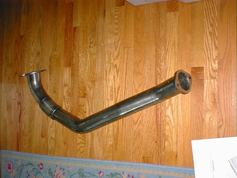

i think that is a HKS downpipe you are talking about
here's mine
http://www.ddmcse.com/turbo/images/3downpipe.JPG
here's where i got it :
http://www.alamomotorsports.com/prod.../indexcat.html
