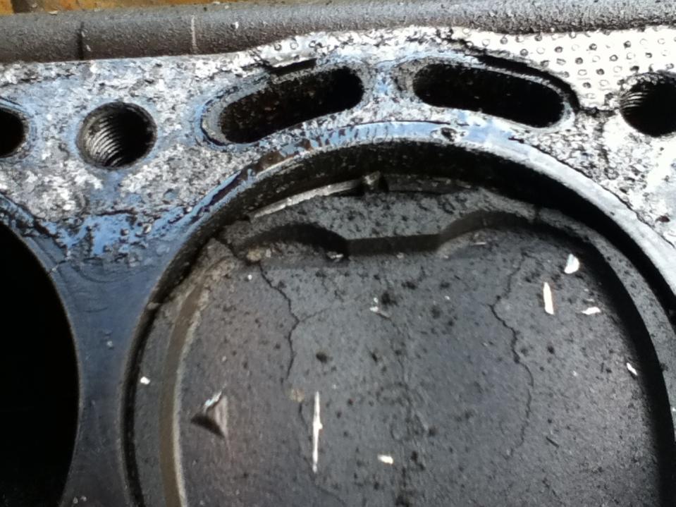

so a while back i got a seized 1987 7mge for 40 dollers. opened it up yesterday and it apears that the pistons were not only busted, but melting may have been the cause:

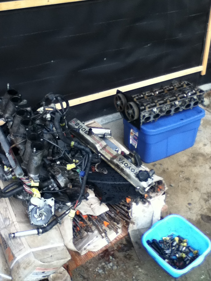

the project is going to be long, and its looking rough so far haha:

Depending on the type of damage you've found you might want to consider getting a hardness test done on the head and block to check for annealing in suspect areas.

First thing I'm doing is getting the block and head checked. I did get it to turn. Just had rusty coolant/water on the piston.
