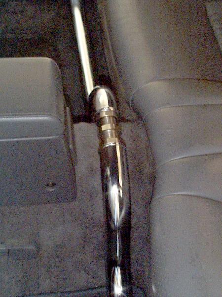

Drcusupra,
This is a Do-Luck (RXB) Center Support Bar. I would imagine it would take
most if not all of your flex worries away. Easy to install and fairly cheap.
This is what the manufacturer has to say;
Drastically stiffens up the weakest point in the unibody frame which helps to
eliminate body flex under extreme loading. Increases torsional as well as
overall structural rigidity. Note that the combination of a front, center and
rear bar works to create an approximate 100% increase in structural rigidity.
Only a rollcage helps further. Especially good for targa-equipped cars.
Cheers!,
-=Littlestan=-

Old 10-12-2005, 12:18 AM   #8
Moonraker
Moonraker's Avatar
Join Date: Jul 2005
Location: Missouri
Posts: 18
Moonraker is on a distinguished road
Default Asking For Trouble
As a professional bodyman, I wouldn't chance the removal of that hardtop. You will have major structural problems with that job, no matter what you buy aftermarket to install to correct. You'll need to take it to a professional to have it done. Talk about TWEAKing one. Wy to much body twist. An easier job would be to find a targa and make swaps to the new carcass.

Old 10-12-2005, 04:40 AM   #10
Suprazeus
Posts: 31
Suprazeus is on a distinguished road
Default Do-Luck (RXB) Center Support Bar
I have a 1991 Hardtop. Its equipped with anti-sway bars (Front and rear) and i am waiting on my front and rear strut tower bars. For some reason im obssesed with stiffening the chassis i geuss I feel saferwhen im taking corners real fast lol. But that middle Support Bar is COOL!!!!! Can anybody tell me where to get it if its worth it for mine since its a hardtop? And also if they make a roll cage for the mkiii and how much it might run me? Thanks
