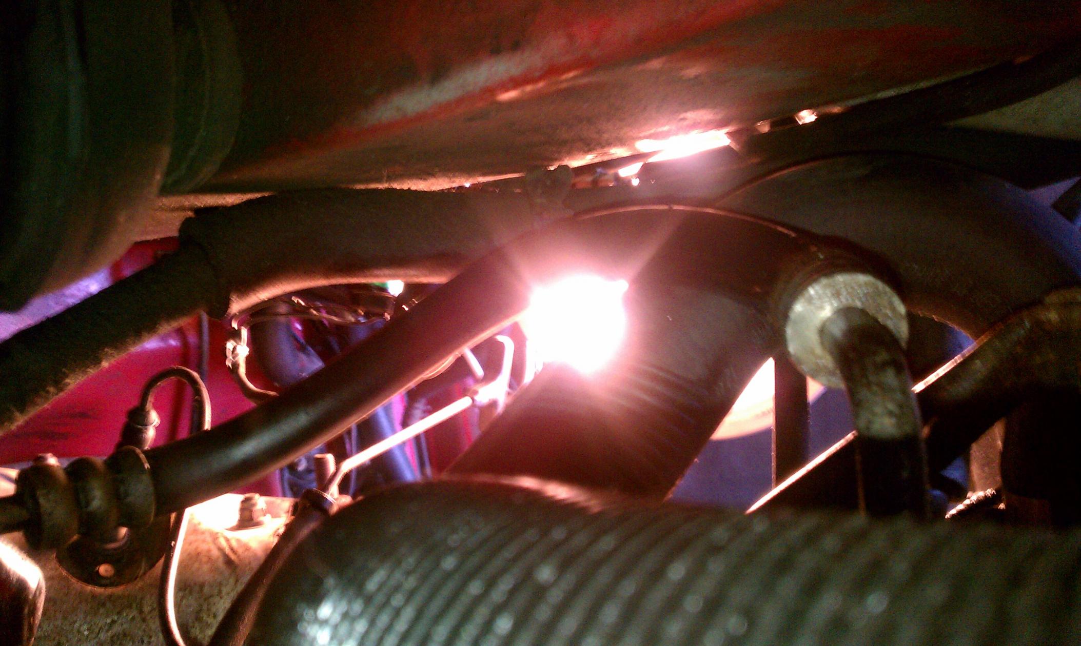

The other night after taking a ride in my 89 NA and backing in into my driveway, I noticed a drip trail that wasn't water. It felt & smelled like ATF fluid.
Sure enough, the power steering reservoir was almost completely empty and there was a lot of my ATF fluid on the garage floor. After inspection, I noticed that the hose coming off of the reservoir seems to be wet & leaking near it's bottom most connection.
In the picture I have attached, it's the hose on the right (the smaller one) that I believe is faulty. How difficult is it to swap this guy out? Can I use aftermarket hoses on this or only OEM? What else can and should I be looking for while I'm down there swapping this one out? Do these hoses normally go fubar or should I be checking out something else?

eh good ol'e rad hose should fix it. slap a new on on there. NOT PLASTIC. Anything able to handle pressure will work fine id imagine. go buy a coil of that diameter for like 5 bucks and be done with it.

Or go to your parts store and get some bulk power steering hose. It's designed for oil/pressure, although typically if something is attached with spring metal hose clamps, there isn't much pressure that you're dealing with.

Well I was way off, those lines are not the ones that are leaking. It looks like the small rubber/metal combo line that goes from the pulley to the rack almost dead center under the engine.

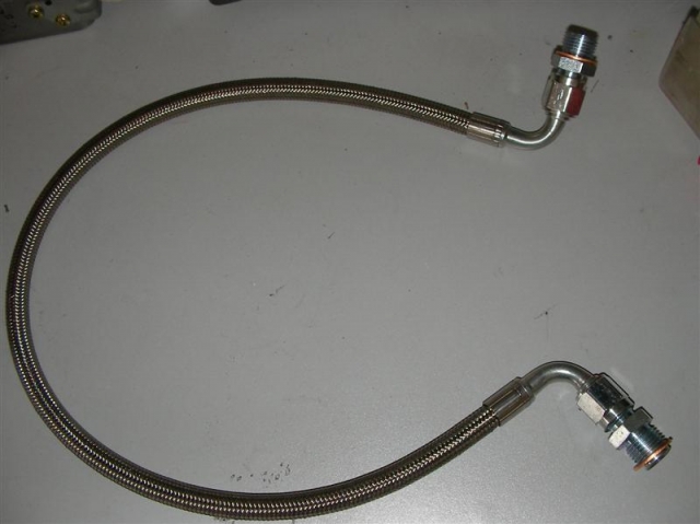

Thanks for the suggestions and tips guys. Any idea on how much those shops are charging you to do that?
I did check out Drift Motion's and while it does look really nice is this really the one I need? Seems to be a bit longer than what I need.
http://store.driftmotion.com/static/...k3mk4sc300.php

Thats the hose for a jz swap. I assume you have a 7mge. This is the 7m one http://store.driftmotion.com/static/i-7mpshose.php
You can have most hydraulic shops (look for tractor and semi repair shops) make the hoses and they will probably have fittings as well. I don't think you will save any money though, just get the drift motion one or a stock one and be done.
