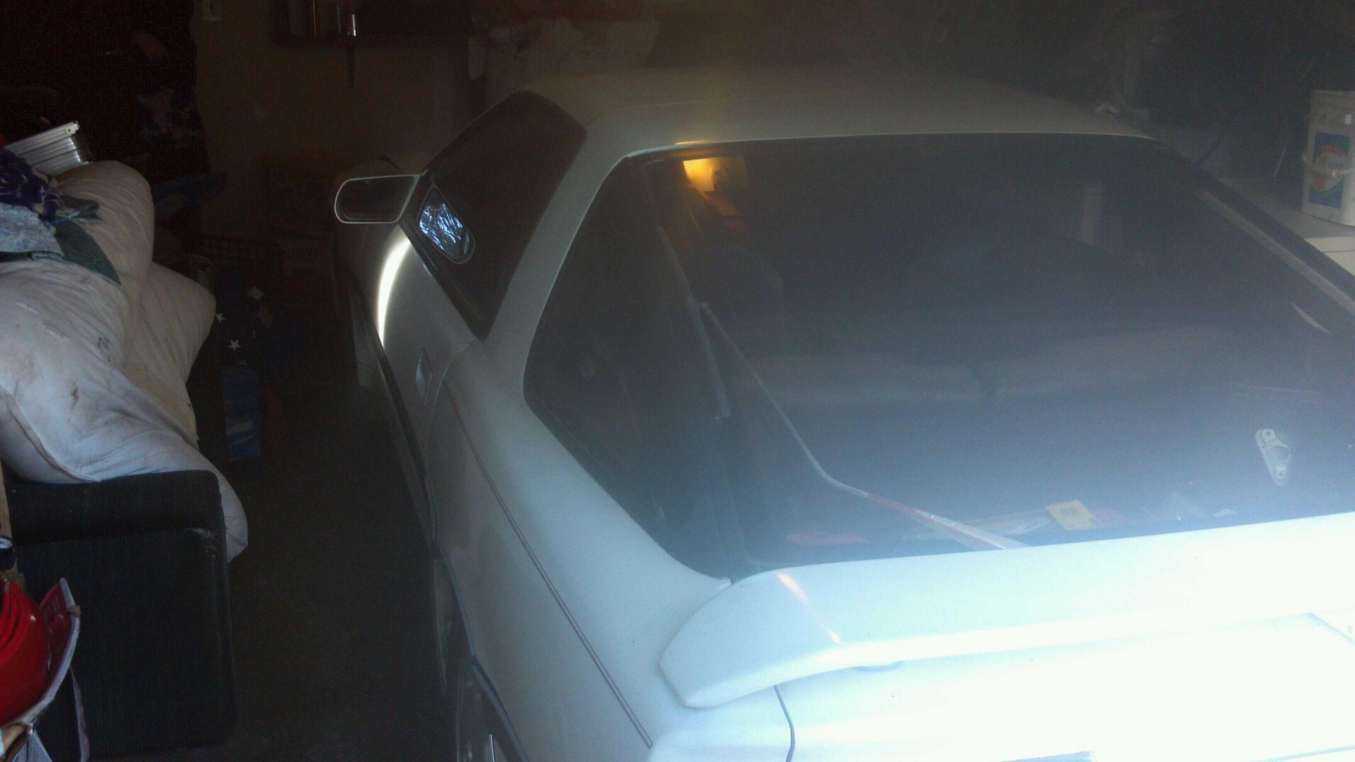

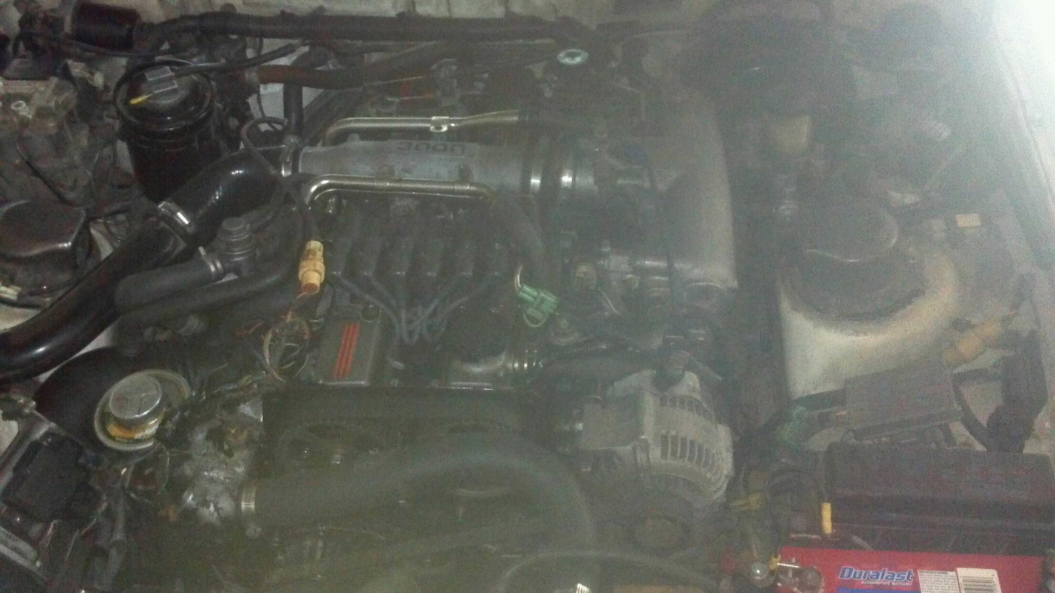

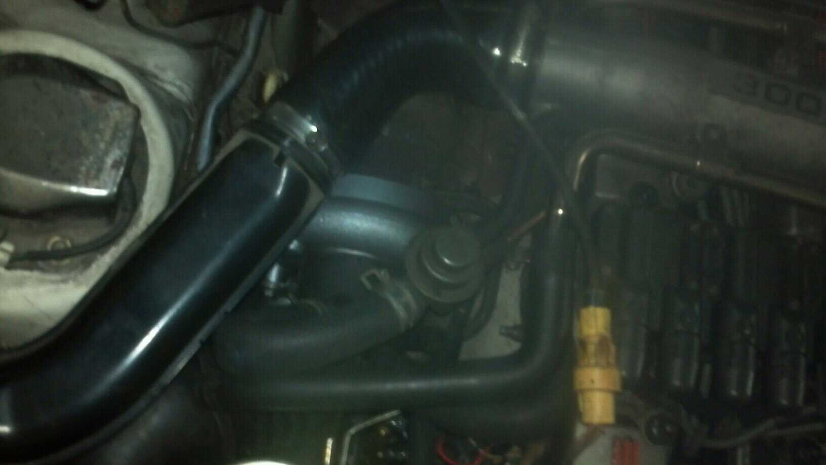

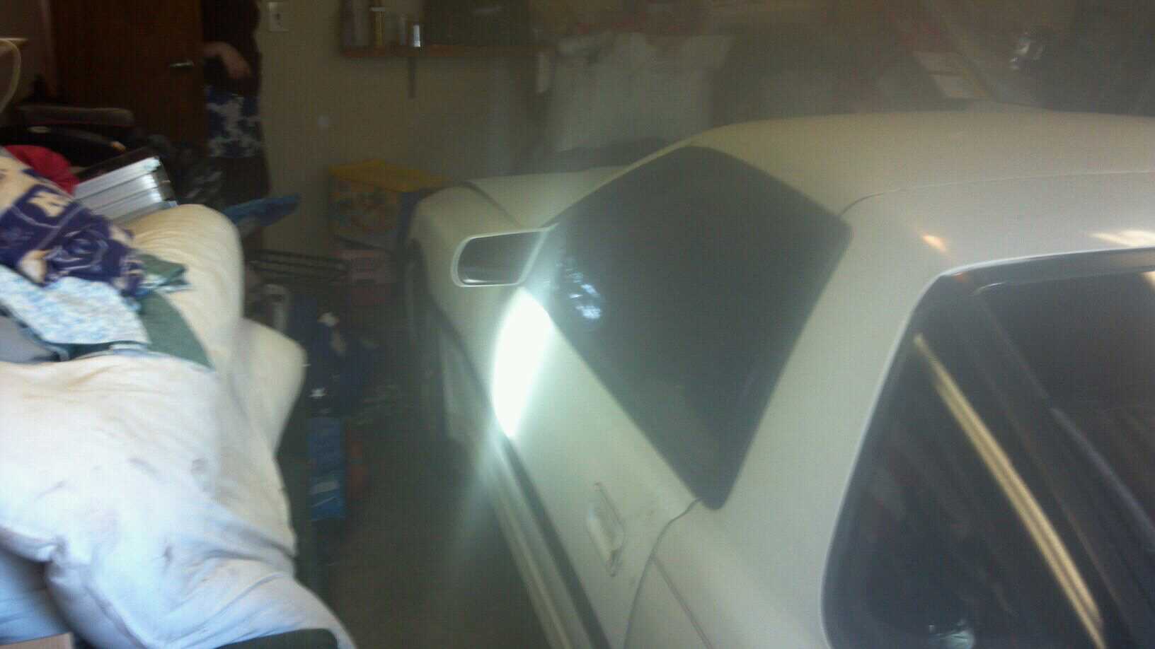

the supra is goin into storage for a year while im deployed, here are some pix of it where its gonna be sittin at, yes the engine bay is a mess but it has come a far way from when i first got it, lol, but this is where its gonna sit for a while, next time it comes out is when it goes to where its gonna be built at, oh i can't wait lol
