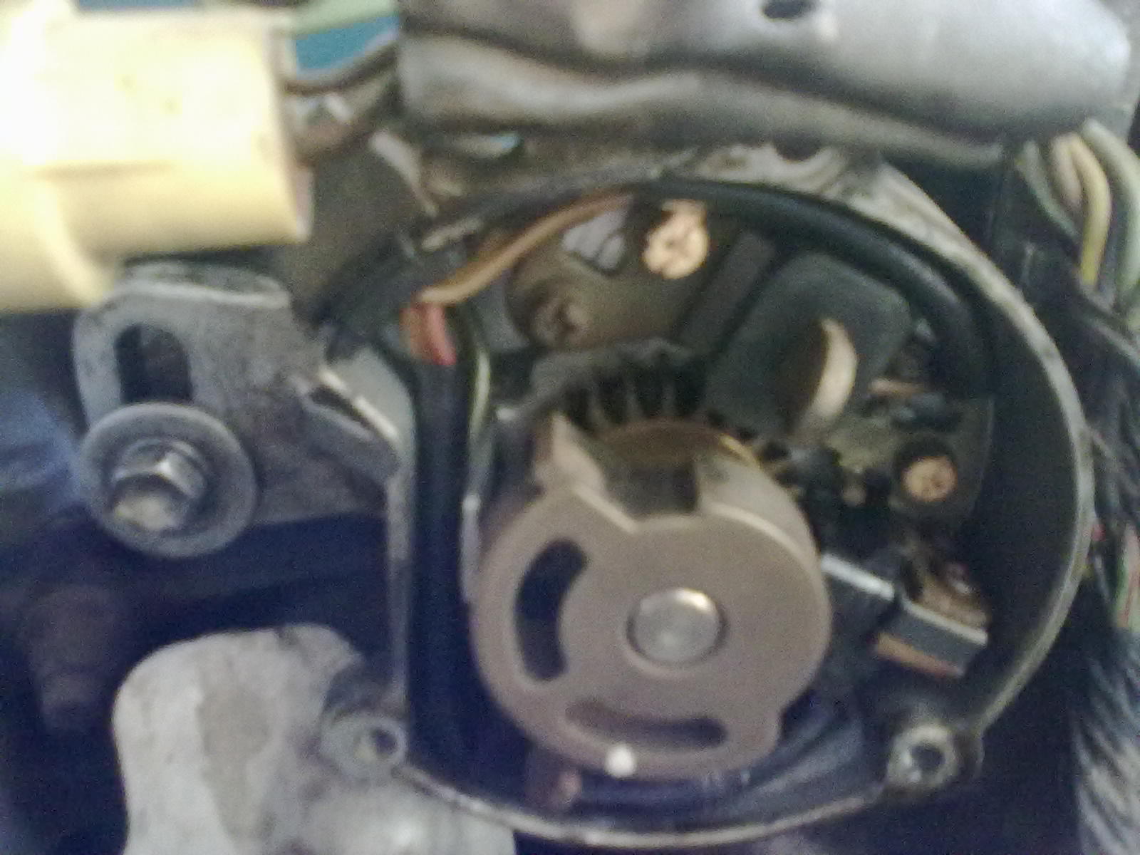

jcastro 05-19-2011 11:18 PM
1 Attachment(s)
Attachment 3943
k have it at tdc and this is what the cps looks like should the should the stationary marker be exactly aligned with the spindle marker
