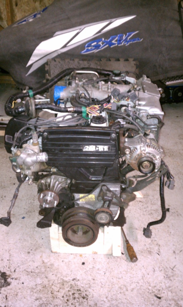

this is the motor that i just got
johnvin is offline   Reply With Quote

johnvin is on a distinguished road
just got the motor for it

sweet deal. do a compression test on it. pretty good deal if all the other stuff was done correctly
