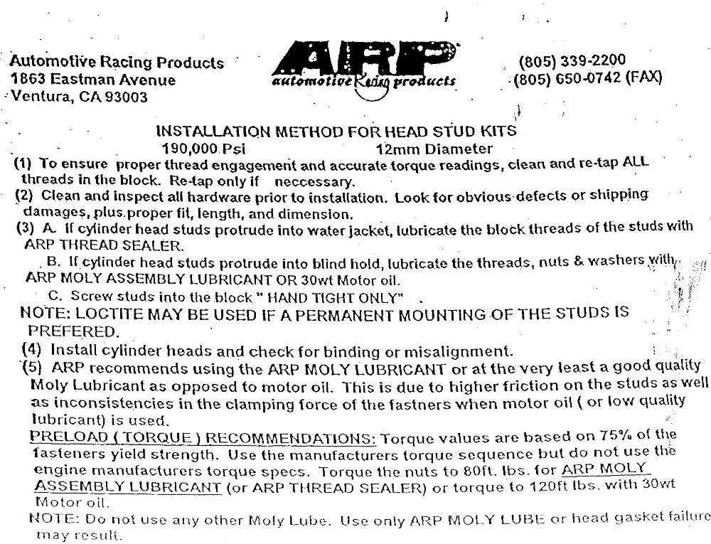

1 Attachment(s)
That measurement at the site you linked to is FOR STUDS (which have a much higher torque than bolts):
80ft lbs with moly, 120ft lbs with regular 30wt oil. Here's a scan:
Attachment 3865
I'll look to see if I have one for bolts lying around when I have the time and think on it.
Now if you're saying 115ft lbs when using oil you need to specify; ARP bolts come with much better lube and as such if someone doesn't understand and torques to that level they will destroy the fasteners and risk damaging the head.
