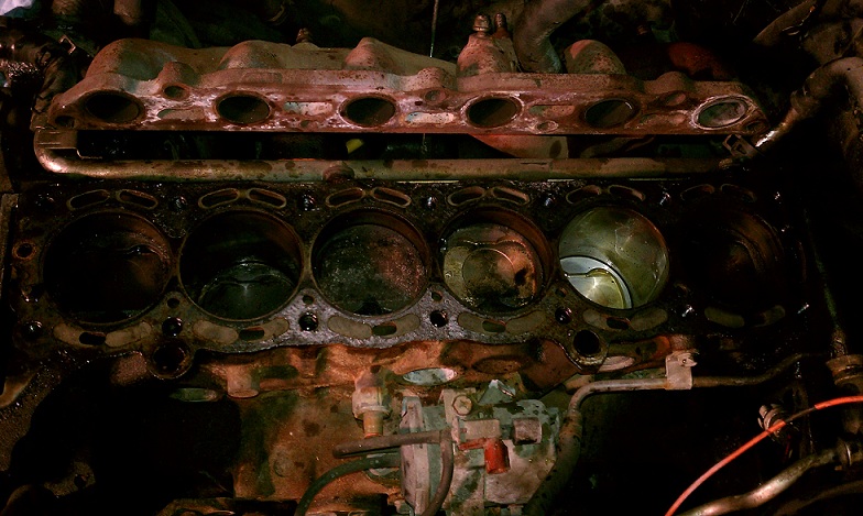

Default got some before pictures for you guys.
here are some before pictures that i'm trying to figure out what it means about my 5th piston its the only one without any corrosion on it at all and this car has over 200k miles on it.
any ideas

Old 01-28-2011, 07:20 AM   #16
Sonyps307
Location: Baltimore
Posts: 526
Yea I was in the junk yard and seen a supra with no head and two pistons looked new and the other were black like they had them to replaced or something
Old 01-28-2011, 07:24 AM   #17
Generally that means it's been steam cleaned by a leak in the head gasket in one of the coolant jackets surrounding that cylinder.

spunkenhimer is on a distinguished road
so most likely that was the piston that had the head gasket leak?
any good tips on how to clean my gasket area and pistons. I'm gonna use a buffer brush and all but wanted to know if anyone had any other suggestions?
