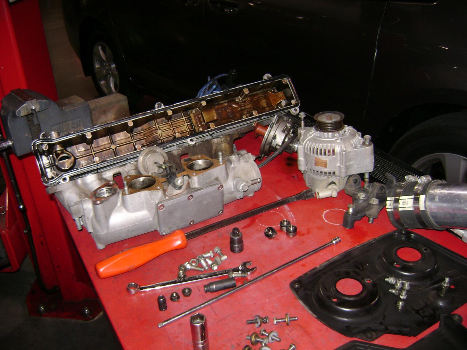

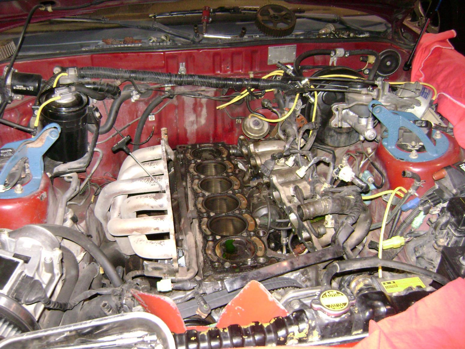

2 Attachment(s)
The car is still in the shop awaiting parts. the cylinder walls look factory nice :)Attachment 3532
Attachment 3533
cre 10-18-2010 12:43 AM
Ahh, but are they still round?

Ranma 10-18-2010 01:49 PM
At least I found the source of that annoying oil leak. The cracked looked like 3 inches or so on the inside of the head.
I am having them change out the Ford drive shaft and doing some rear end work as well.
