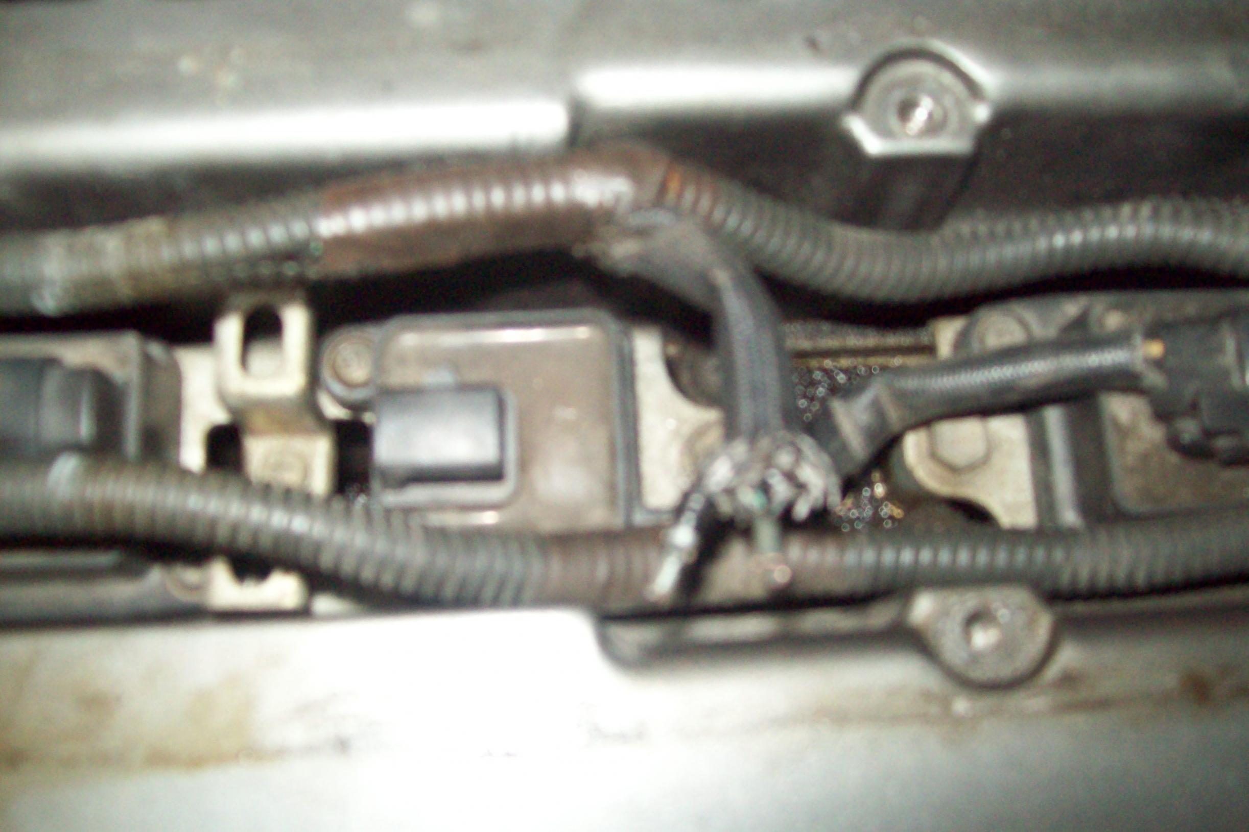

Ok so my coilpack harness is broken, how the heck can i fix it,
any help will be greatly appreciated

ima post a reply so more ppl can veiw lol.
uhm what broke,
i see a wire that came lose.
or something...
maybe a better picture?

the coil pack that sits ontop of the spark plug broke off it looks like...
never worked on that engine before so I cant really comment.. pull one from a part car or have it ordered.. I would replace the hole thing tho, and not just the top

Looks like you broke a wire off your wiring harness, just splice in a new wire with the proper connector. Appears to be off the harness not the pack. Insulate the break with electrical tape or with a wire splice connector wrapped in electrical tape. That is if it is not a coil wire.

Yeah the harness broke but one of the wires inside the harness is broken, not the actual wire, but the connector part, if that makes sense.

find the lock on the metal prong that goes into the connector (the piece your showing us) it will have a small lock or basically a pertruded piece of metal coming off of it just bend it out more and insert it back into the original plug and for extra strength add a dab of superglue to it ive done it a hundred times and have never had one fail a second time

problem is, one of the two is broken!
