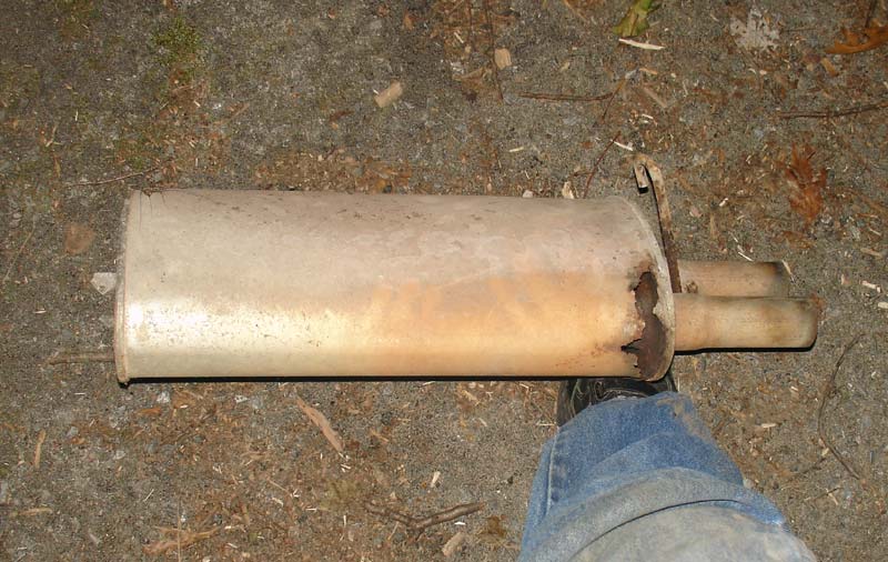

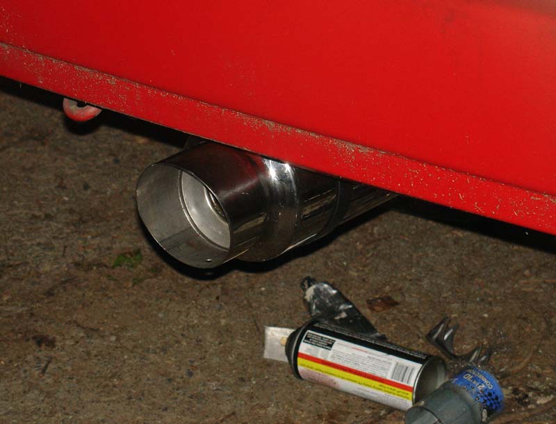

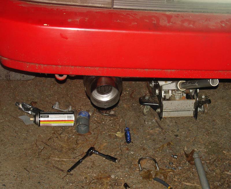

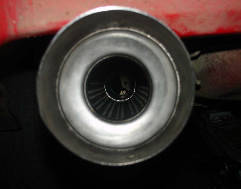

Anyone know what size can this is? What Brand? No markings ion it and I got from some kid in a parking lot for 10 or 20 bucks. It has a real deep throat sound. Low budget 101 here ....will do for now. I got that black aluminum strap hanger from Home depot plumbing supplies, a few clamps and a hacksaw and I seem to be in business. Have a couple things to seal up cause of the old pipe not being the best but I think this will work out fine for now. It seems to be what everyone is putting on these cars and lord and behold I have one in the garage already.... go figure that!
Just trying to make it through WV Inspection
Full Throttle Thanks for posting we must have been posting at the same time. Yeah a Video would be great! Thanks !
