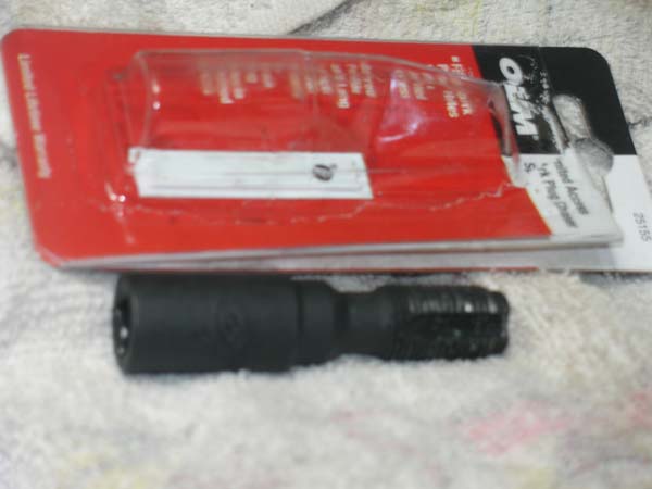

As I think you've found now that you've dug a bit more, this isn't a "part it out" type of problem... quite repairable. Given that I can't look and see what you're dealing with my first suggestion would be to try a tap to see if there are threads still present and if they're just distorted... then, if need be, use an insert repair. My preference is a timesert, but yes, there are many different options.

You are right Cre, we humans sometimes throw our hands up in despair and cry why me oh lord, WHY ME??? But then I found that info and I called Auto Zone and for $10.00 and a trip to town I bought a thread chaser part number 25155 put some oil on it and chased the threads through. #5 plug is now in and tight! I will read your link though because though it is in lord know what I will find in 2, 3 and 4. Those must be some old plugs under the plenum. I will be taking the rest of the plugs out and doing the valve covers and taking a compression test I suppose. I just want to get it running again before I do all that. I ordered a fuel pump from Ebay and will do those diagnostics now. Looks like I have to buy a roll of vacume line and replace the vacuum lines just cause they look dry and possible might be leaking. Here is a pic of the tool I used.
