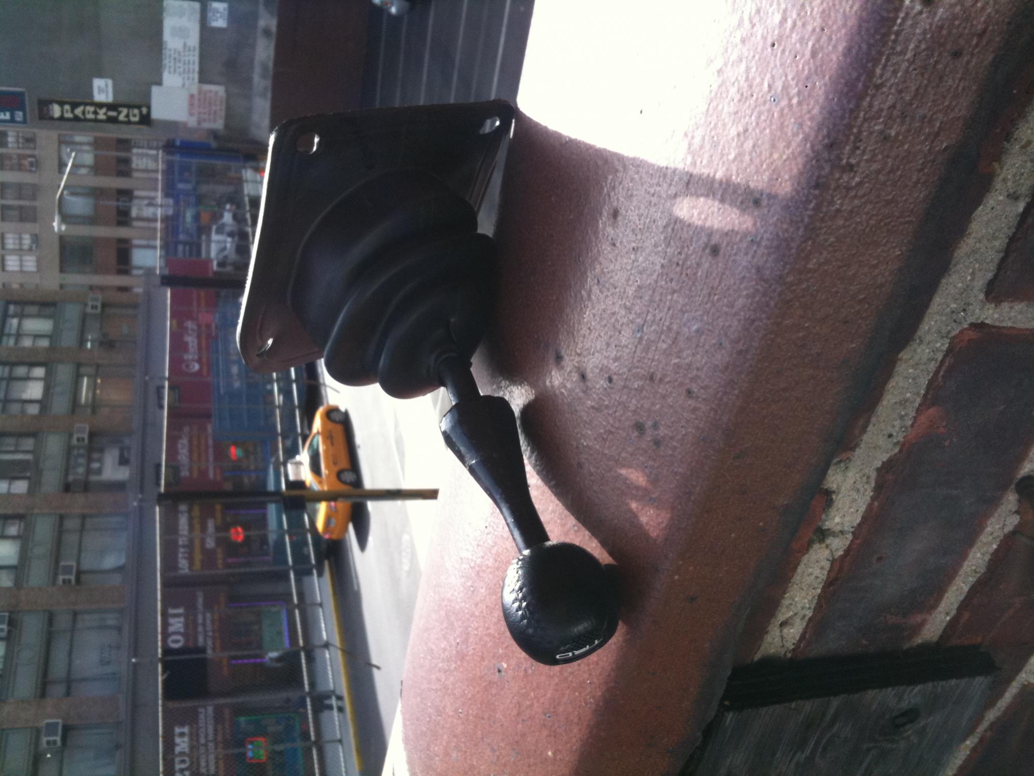

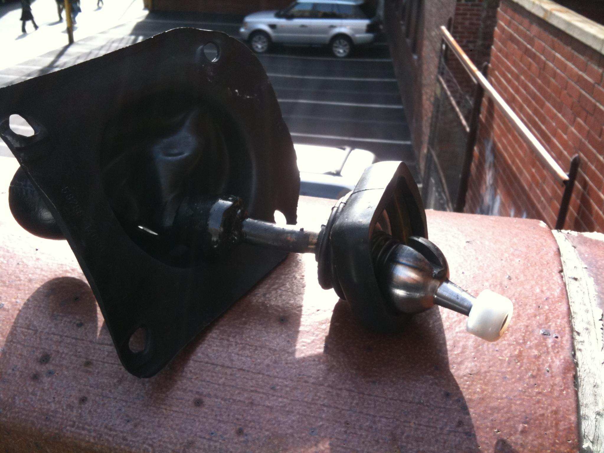

i started my project today...the shifter is the stock shifter but custom fabricated to be a short shifter topped with a TRD leather ball...im changing the clutch to oem exedy and the flywheel is a 15lb fidanza flywheel...the aluminum driveshaft came in at 15lb compared to the that 40lb factory DS. i was surprised to find out how heavy the stock shift and yes i have heard the vibration that sometimes comes with aluminum DS but i heard all good reviews from shaftmasters...well ill keep you guys posted and of course your input is always welcomed

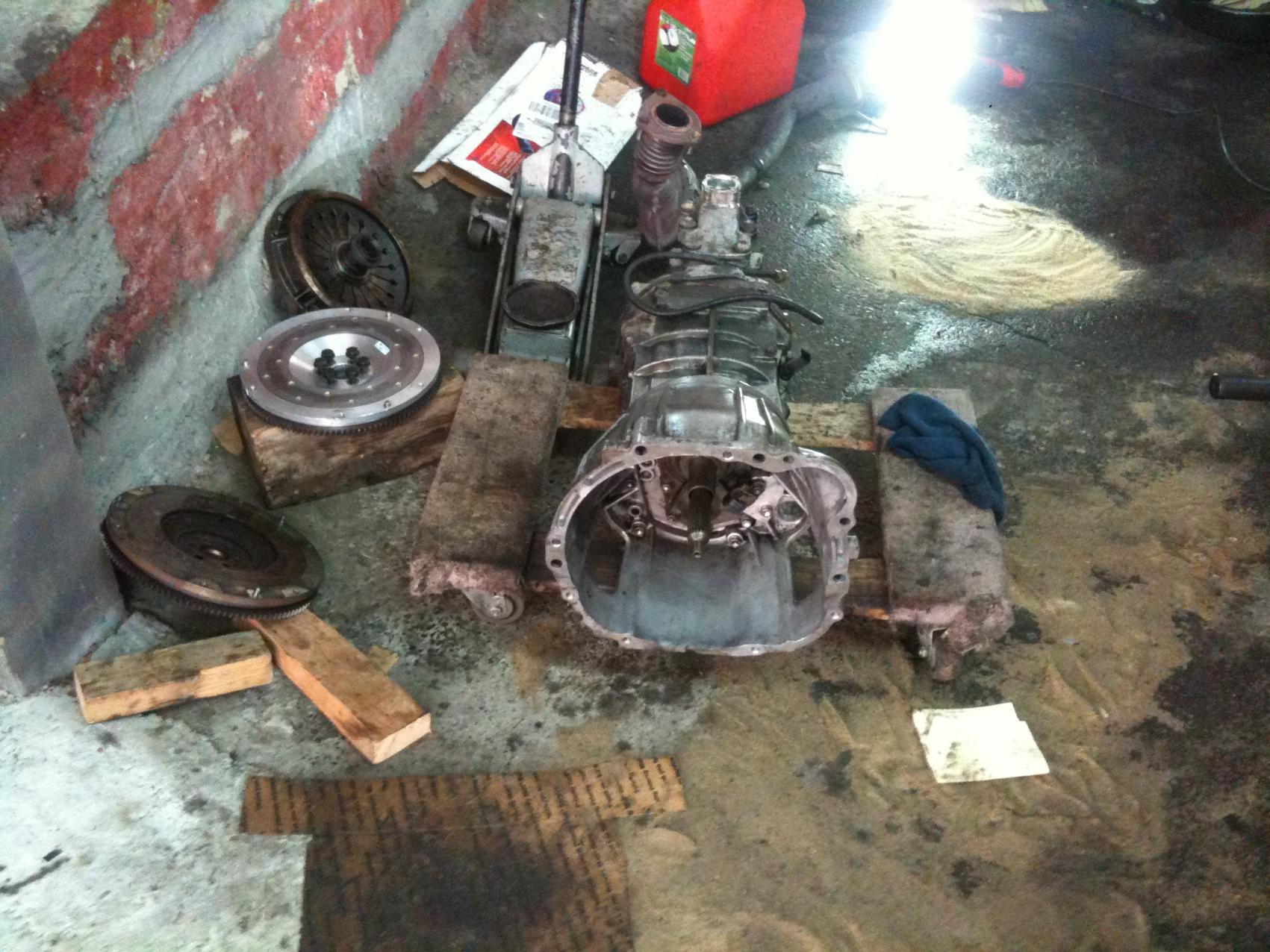

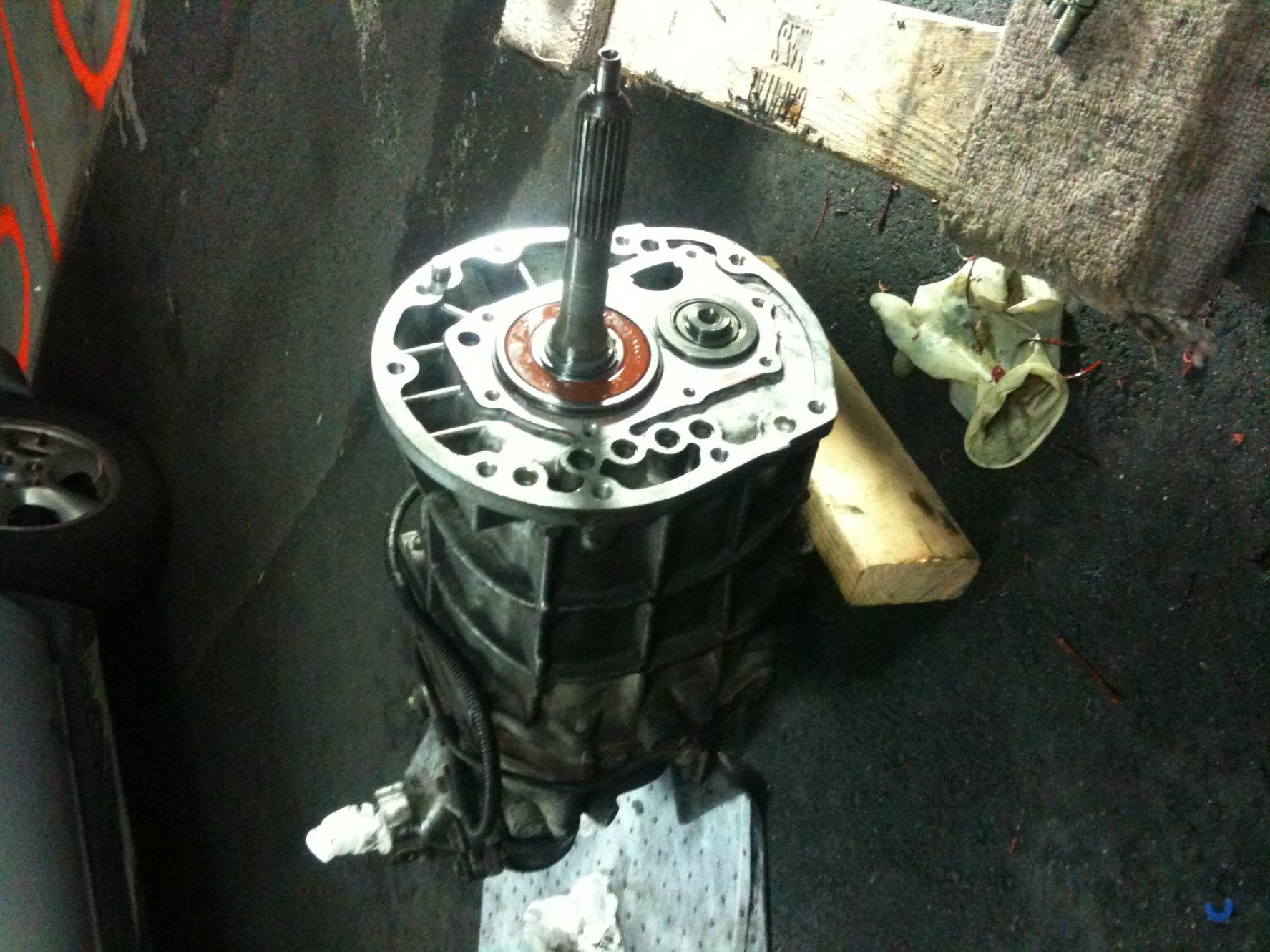

i got the r154 out and cleaned it up, much to my surprised it had been rebuilt, looks like under 10,000miles on it...i put in new gaskets and ball bearing where needed...i installed everything but have a problem that will be fixed tomorrow...air got caught in the clutch system, im bleeding out the system, putting in new fluid, along with a stainless stain clutch line...ill keep u guys updated

Turns out we put the clutch backwards -__-
