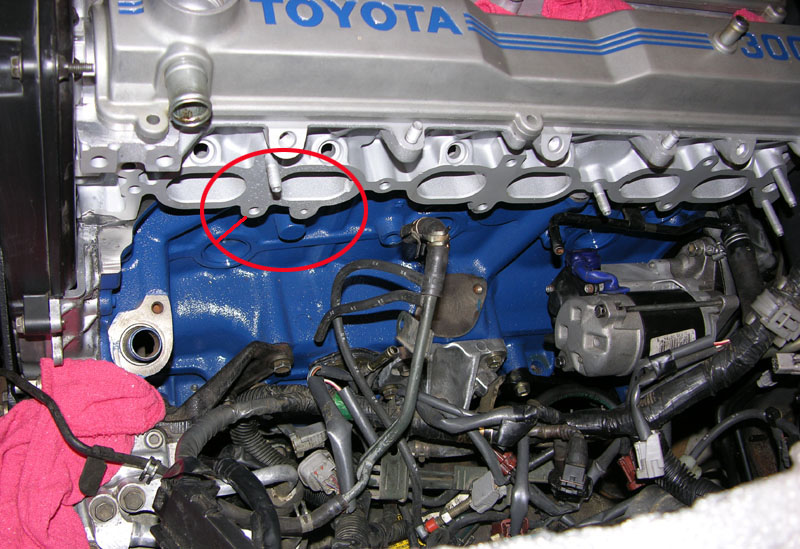

except a leak underneath the intake runner (that tiny nipple i was trying to find before. but it actually doesnt look like its coming from the hose. looks like coolant is leaking from where the intake runner and the engine head meet..... im so lost. this will be the 4 time taking everything apart. any ideas?
thanks
cre 01-12-2010 02:16 AM
The coolant channel passes through the runner's flange and into the head. If the gasket is damaged or poorly sealing it will leak.
oregonjoe 01-12-2010 03:34 AM
Water Through Intake Runner
2 Attachment(s)
Yup - true as rain. That magic nipple under the intake runner feeds right through to the head and if the gasket is not right - will leak. I RTV every place where coolant can leak. .
Attachment 2724
Also don't forget about the coolant bypass that goes up to the throttle body as well
Attachment 2725
RTV the Intake runner on both sides where the collant passes through, Rtv all coolant hoses
No leaks yet,

cre 01-12-2010 03:40 AM
Excellent! Thanks for the pics Joe!
One thing to note is that if the gasket has a viton coating for that passage you need to be very careful about any sealants you might want to use on them... most contain enough trace solvents to cause the viton to bubble or ripple and may actually cause a worse leak than allowing the viton to do its job. If there is no sealant present, then YES, a thin coat of RTV is the way to go. I've had both types of gaskets in the past and neither leaked... never tried one with no sealant.
