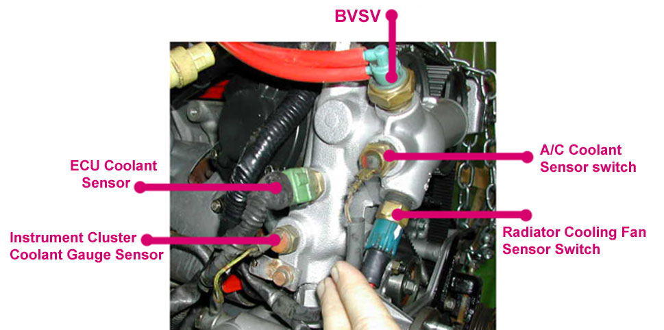

also i dnt know what this sensor is its located on the thermostat housing its the therid one on the bottum thanks for all the help u guys sure save alot of time and help out alot

You only have 2 sensor locations on the thermostat housing? If so then I presume it's because your car is an '88 or older. The three position thermostat necks was on '89 GTEs and newer if I recall correctly.
Here's what the sensors are and their locations:
