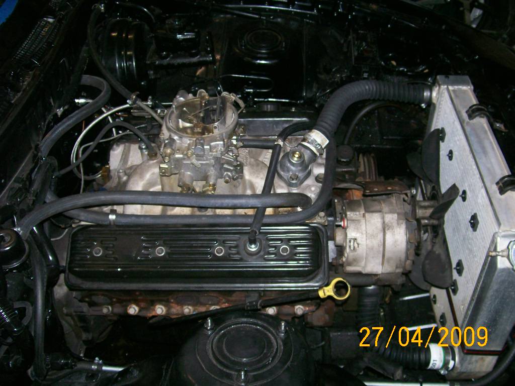

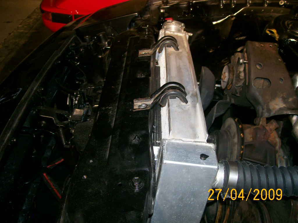

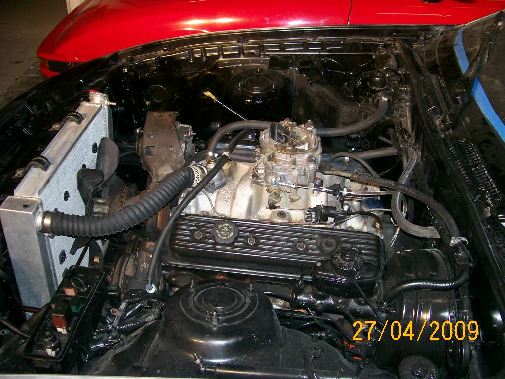

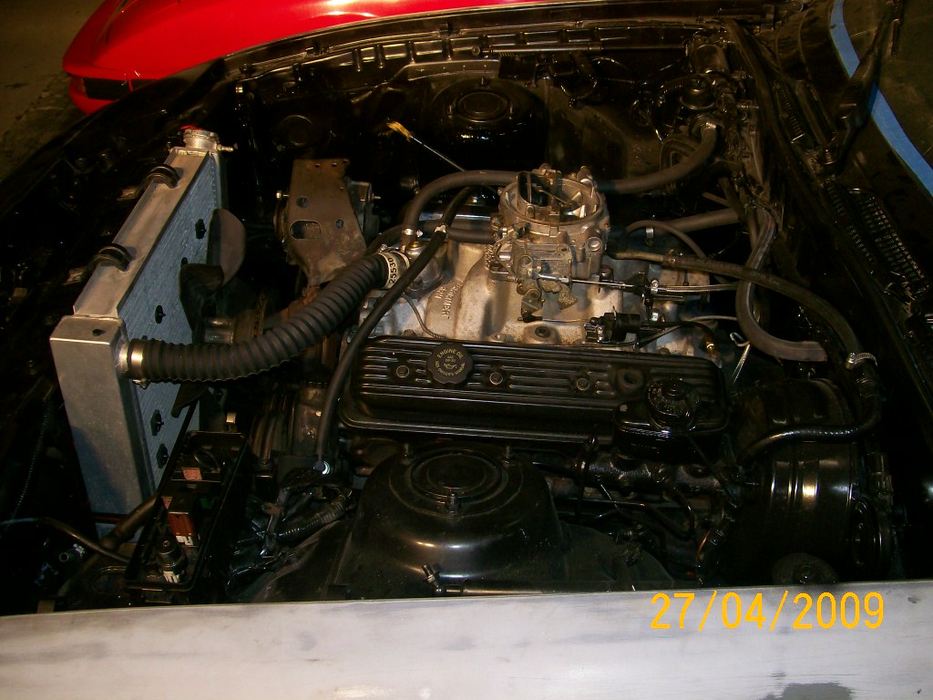

Making progress. Not much left to do now. I'll have this thing up and running shortly. Need to take the 2 driveshafts and have 1 made. The second driveshaft was pretty easy to find at the local salvage yard. From a 1986 Chevy truck with a 700R4. Also picked up some tubular exhaust that fits nice too! This thing however, is nickel and dimin' me to death though. It's all the small things that add up quick. Transmission and throttle linkage, hose, clamps, belts, universal throttle linkage kit, PCV valves, dual transmission fluid coolers, wire, gaskets, flexible firewall mount transmission dipstick, etc. Anyway, here are a few more pictures of where I am now.
VT247
