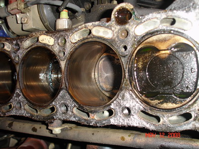

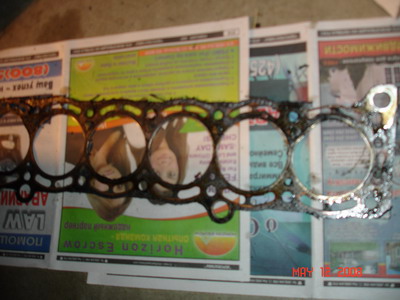

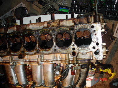

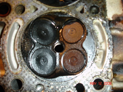

this is how it looks like I took it apart...the gasket looks very badly. At list three of my cylinders are blown...
any suggestions?
