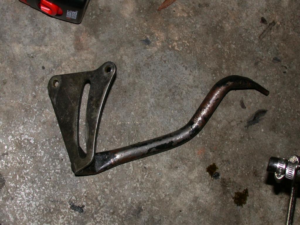

Hey all, anyone have any idea which bracket this is?
(Funny thing is I didn't take this picture, someone else did and the caption was what the hell is this.....)

Power steering pump bracket. Mine is 2 pieces on my 91 N/A.
That ovular groove is where the nut goes to the pump so you can adjust the tension on the belt.
The bottom back bar connects right to the block down by the oil filter. Again, this is how it is on my n/a.
The front 2 holes attach beneath the t-stat housing. Before you get near the timing belt cover.

^^^^^bingo!
Excellent eye.

Thanks guys, that was it!!!
